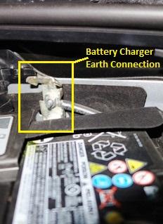

            Incidentally, if you are charging the battery - make sure that you don't connect the negative charger lead directly to the negative battery post; ALWAYS use the special "up-stand" facility near the battery (see below), or connect the negative charger lead to a bolt on the car body
