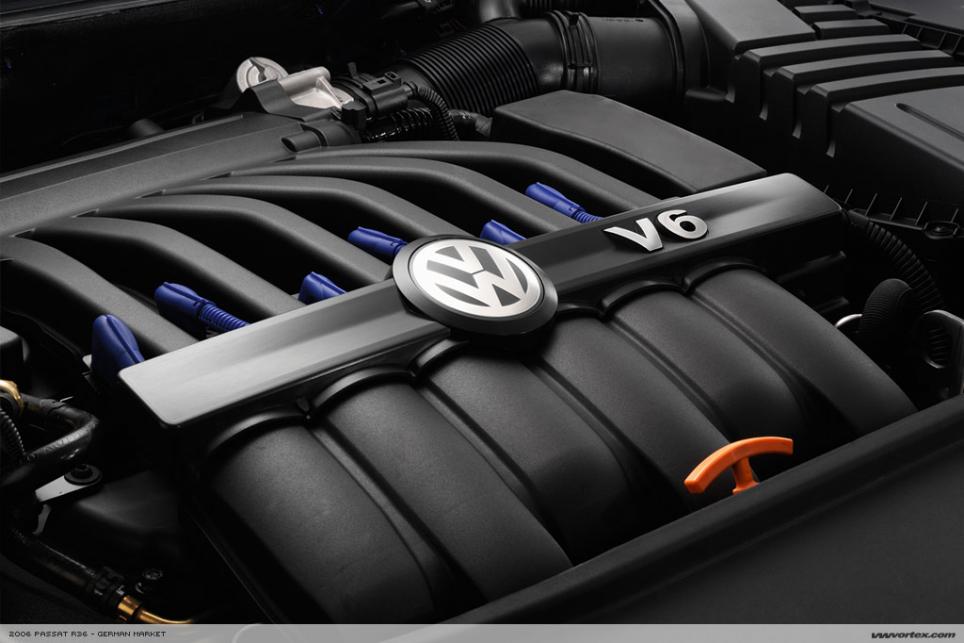

                    Huh? R36 PASSAT is a VR6 - narrow angle - not a 90 degree V6. As is the 3.2 Passat - a VR6 but with FSI where the R32 doesn't have it...

                      i was talking about the 3.2L V6 highline. not the r36.
                      you will find that the 3.2L v6 in the passat is the same as an audi 3.2L v6 engine.
                      have a look at the displacment and bore and stroke. they are not the same as the 3.2L VR6

                        The R32 motor is a 15 degree VR6 engine, no FSI.
                        The Passat B6s come with choice of two 10.6 degree VR6 engines - either a 3.2 available in the 4motion, or the 3.6 in the R36. Both are FSI.
                        The previous generation Passats had longitudinal mount engines. B6s are VR6, not V6...

                          The bore / stroke is different because it's a different engine. It's a smaller version if the 10.6 degree 3.6, not the 15 degree 3.2 in the Golf. It's NOT the Audi engine...

                            according to Volkswagen Australia, the 3.2L V6 in the passat has a displacement of 3168cc.
                            The 10.6deg VR6 has a displacement of 3189cc.
                            bore and stroke of the aussie 3.2L V6 is 86/90.9.
                            bore and stroke of 10.6deg VR6 is 84/95.9.

                              ETKA for current generation (B6) Passats shows the 3.2 / 3.6 as the same configuration / layout
                              The engine in my 3.6 is the BWS engine code. The 3.2 is AXZ.
