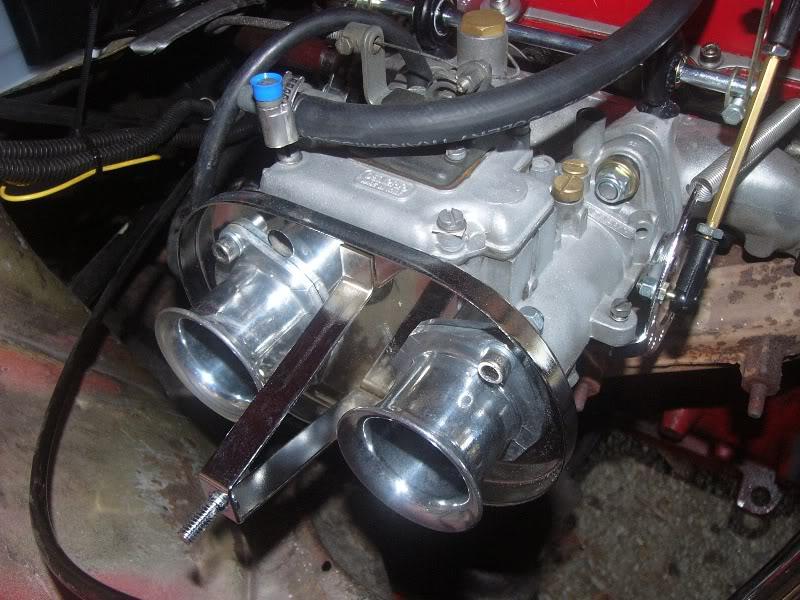

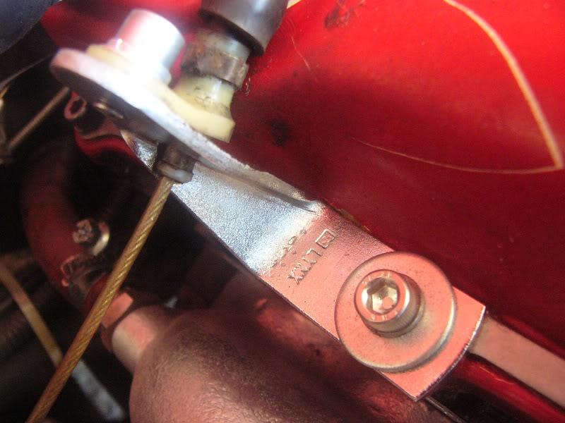

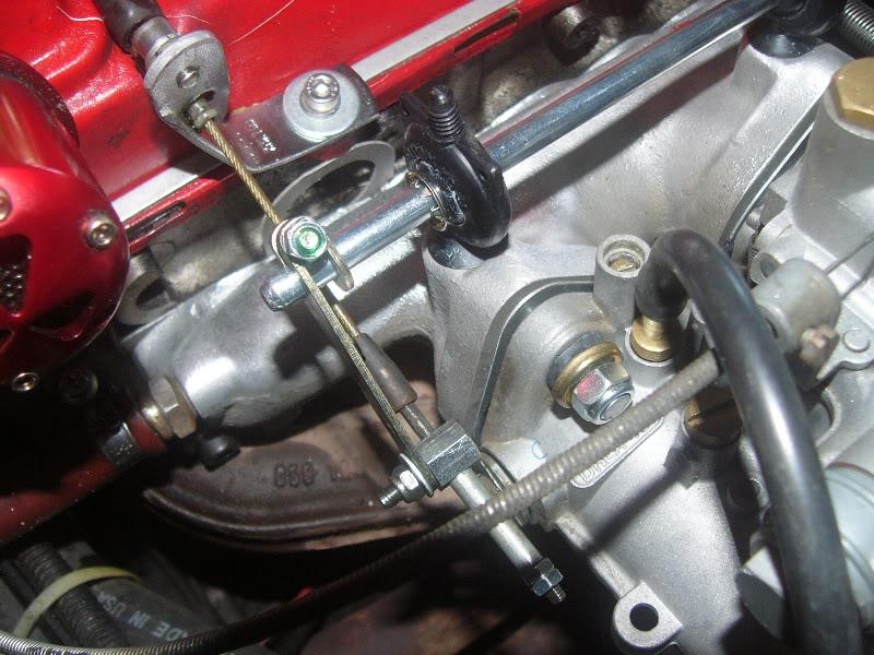

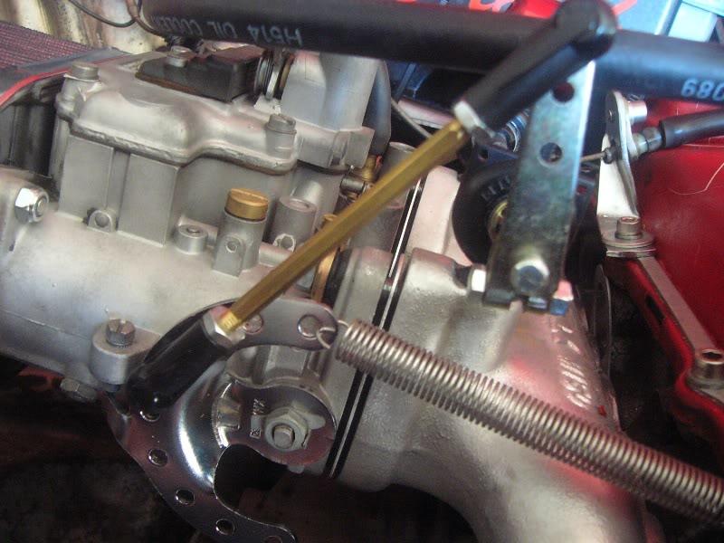

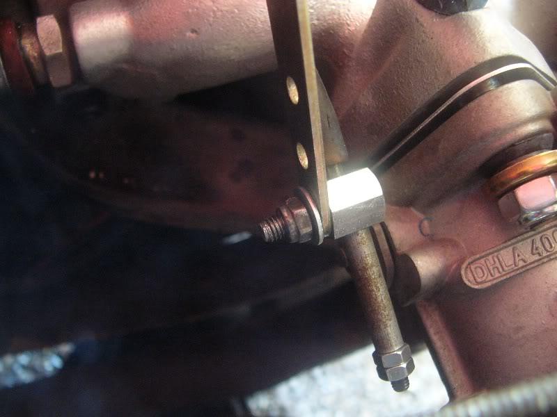

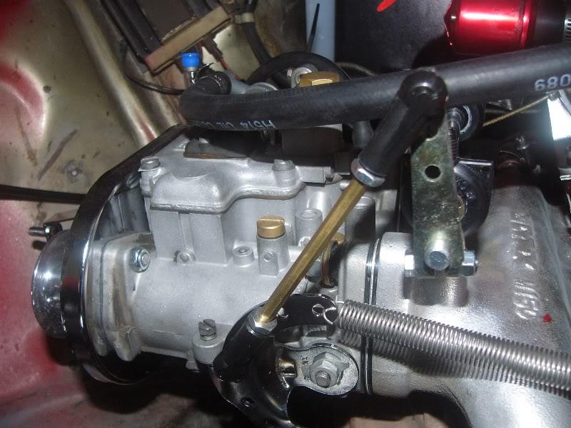

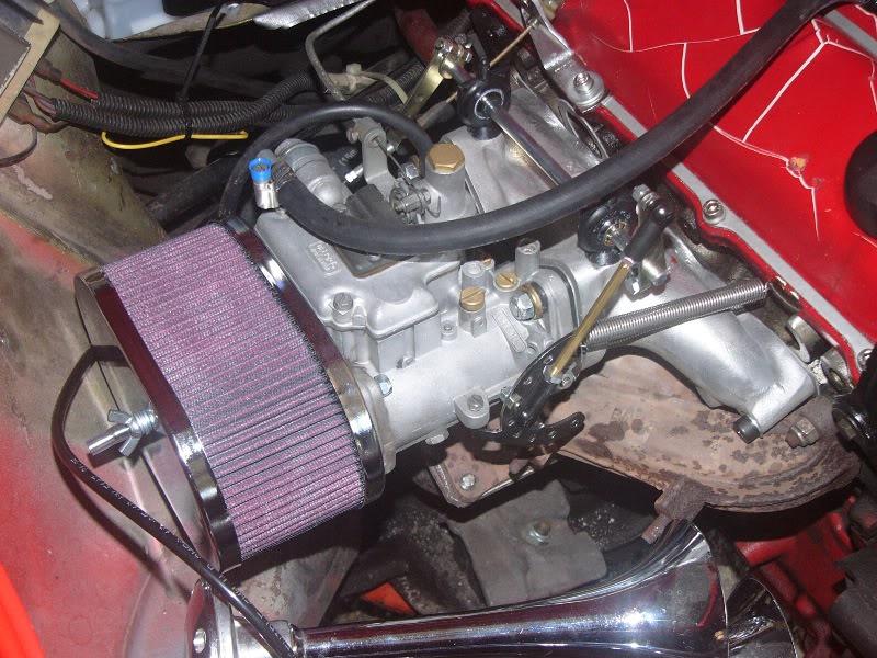

        • Here's some detail of the installation.
          The linkages came up really well.

              • A note on the linkage kit.
                Once upon a time Lynx used to manufacture manifolds in Australia. All their manifolds were cast to accept their own linkage kits.
                Lynx don't make manifolds any more but they do still make the linkage kits.
                So if you ever get a second hand Lynx manifold all you have to do is give the nice people at LYNX a call and place an order. Same place does all the Ramflo bits and pieces.

                    • But how does it go? I hear you ask.
                      Jodie's driven it and says it's more responsive and keeps making power high up in the RPM range. Acceleration is better so there's probably a few more horses in it.
                      The head has been ported, I saw the inlet ports for the first time while installing the cab and it looks like a good job.
                      The valves themselves look a bit coked up, I'll have to reco the head sometime down the track.
                      It's pinging a little, I'll drive it tomorrow and back the timing off a bit.

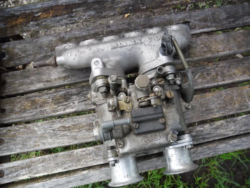

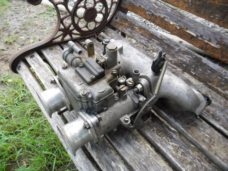

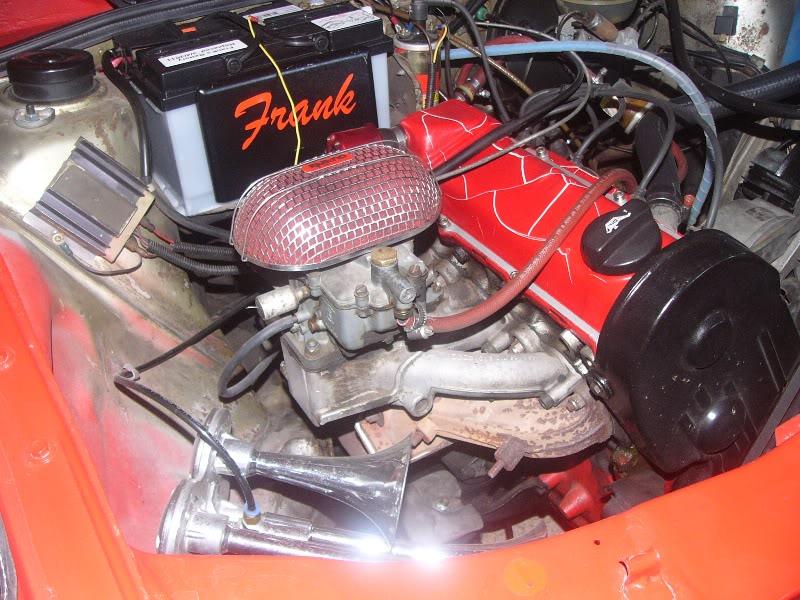

                      • Here is how the carb looked when I bought it.
                        It was in really good nick, all I had to do was give it a good clean.

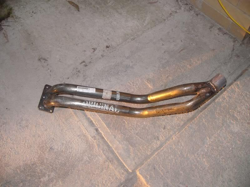

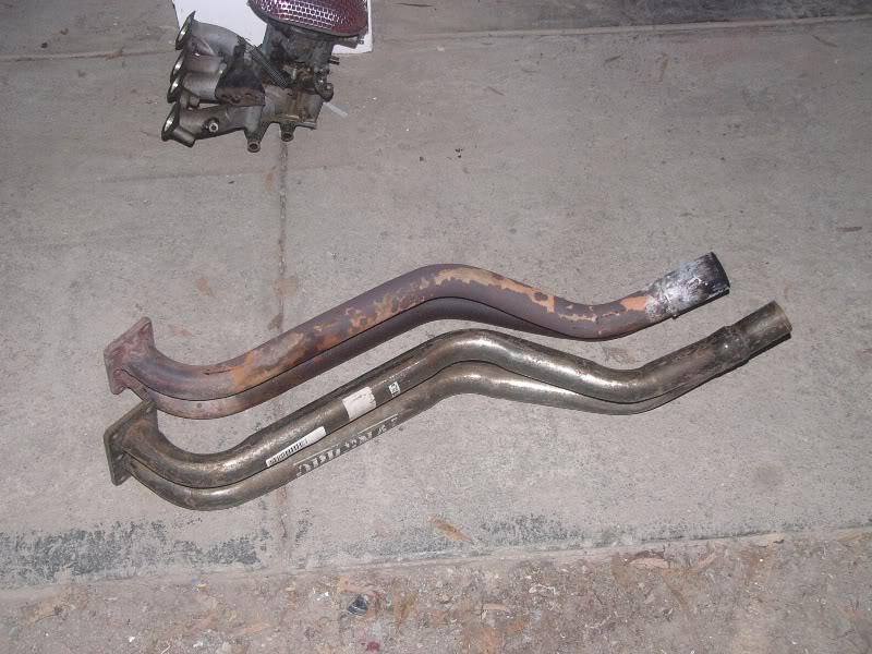

                        • I've had to repair the down pipe previously.
                          We managed to pick up a new downpipe at SEDF but the outlet size is wrong for the 2" system we had fitted.
                          WHile I had the inlet manifold off I removed the current down pie and test fitted the new pipe so I could weld on the adapting piece.
                          The plan is to get the new pipe ceramic coated.

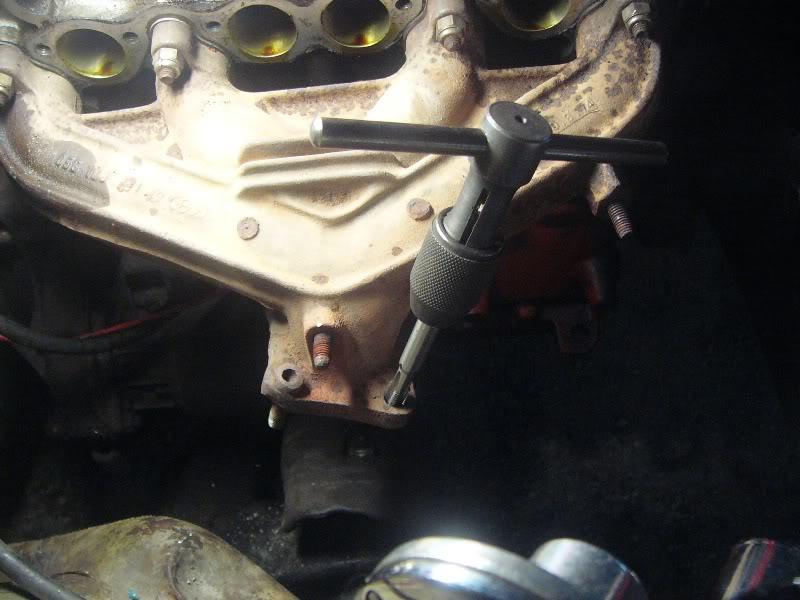

                          Of course one of the exhaust manifold threads stripped out, so I had to drill it out and helicoil it.
                          Hopefully we'll drop the pipe off for coating tomorrow.

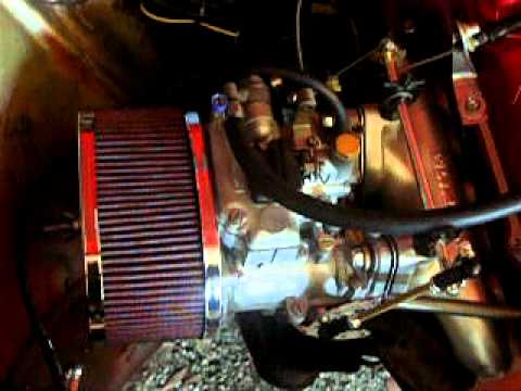

                              • Dropped the down pipe off for ceramic coating today and got a few miles up on the Dellorto.
                                I wound the timing back 2° as it was pinging a little, it was about 3° advanced in any case.

                                Carby works extremely well, really smooth power delivery, much better than the progressive that was on it.
