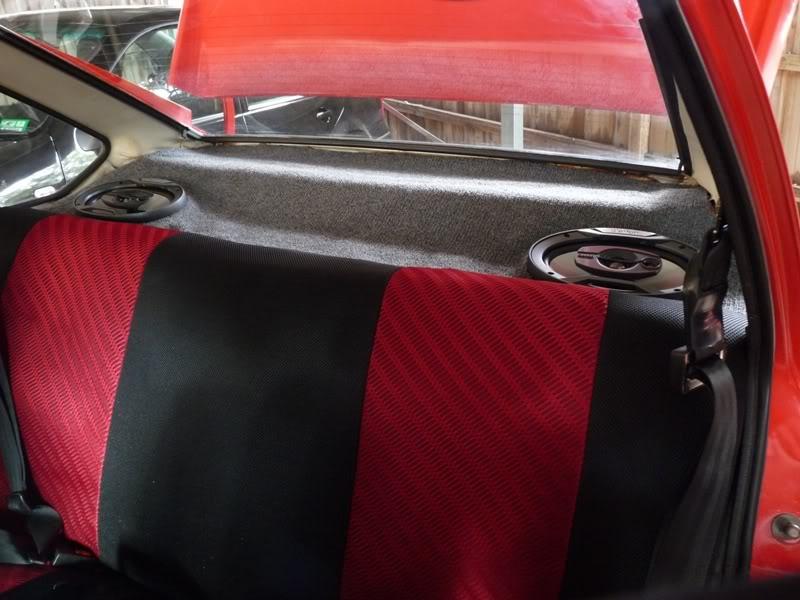

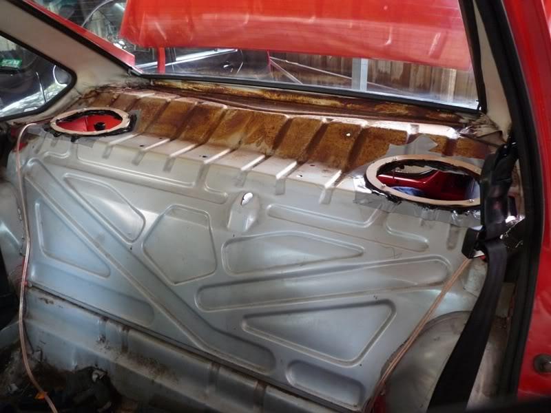

                    • Spent most of the day stuffing about with speaker mountings.
                      The parcel shelf had been butchered by a previous owner so I re-used the holes as best I could.
                      That area of the deck isn't flat so I had to do some not so high-tech carving of MDF to make up some spacers.
                      The car is to be re trimmed own the track, I'll probably rethink this approach.
                      I sealed the spacers down with silastic but stuck duct tape down prior so it'll be easy to remove.
                      Speakers are fastened to the deck with M4 nutserts.
                      Temporary carpet back in place. Grills will go on the speakers when the final trim has been done.

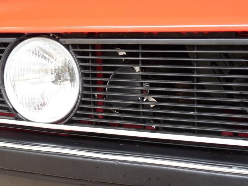

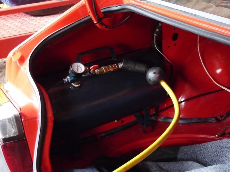

                      Air supply for the horn mounted up neatly out of the way behind the left hand tail light.
                      Just visible behind the grill

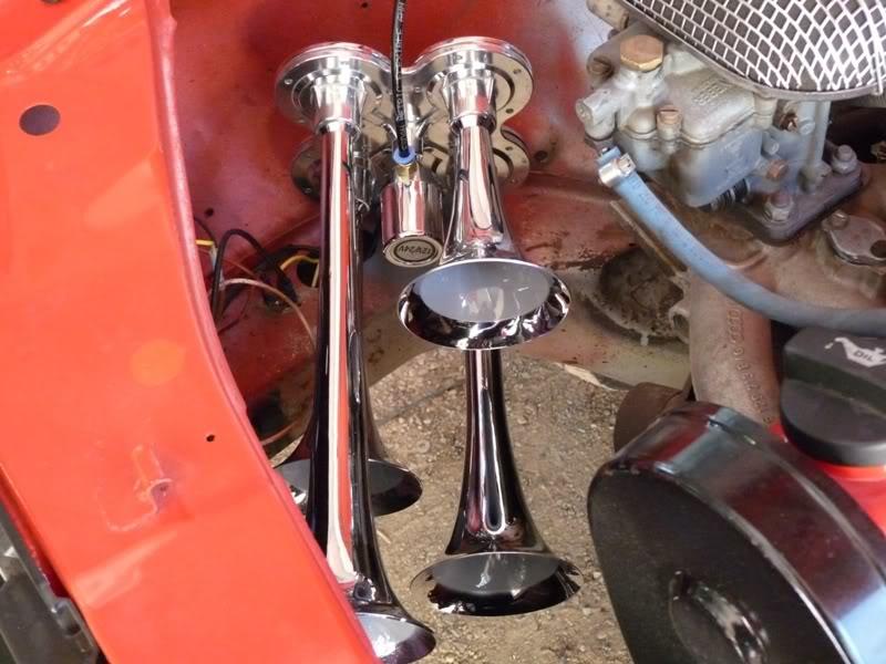

                          • Haha that air tank is nuts!!! Is it necessary to be that big or is it just cause you can?
                            • Originally posted by DubSteve View Post
                              It's what I had lying about Plus you need more than one toot between refills. Hardest bit is to stop these systems gradually loosing pressure.
                              @ 100 - 150psi these horns are louder than suburban trains.

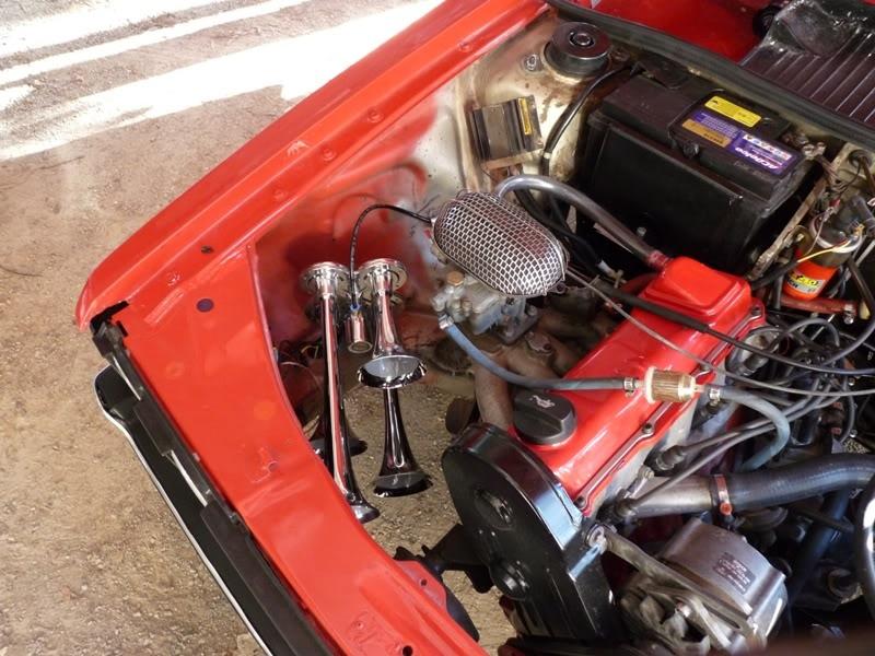

                              • Looking good, and that horn is a piece of work.
                                I still you've got the fuel filter between the pump and the carby. I thought this was a bit of a no-no?
