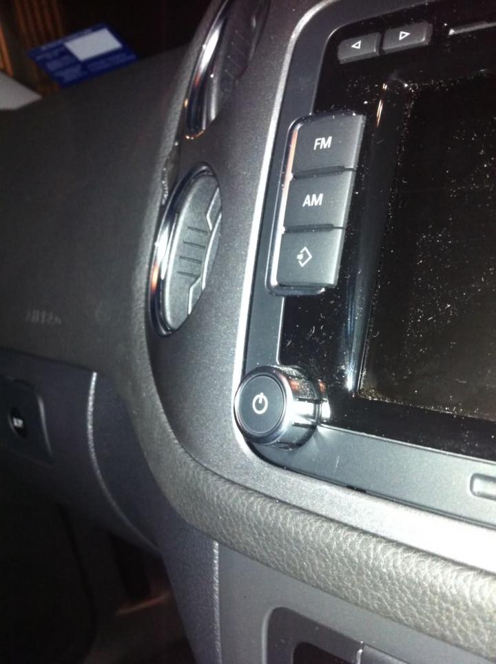

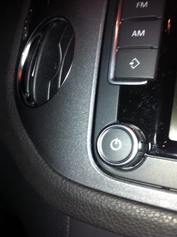

                SUCCESS!
                Did the install and everything works fine. No coding needed, the climate control, ops and bluetooth all works fine.
                One small thing that's going to annoy me though is the bezel isn't sitting as far back as possible and there's a small gap:
                and
                Bit hard to see in the photo but its annoying me.. I might take it off again and try pull the head unit forward a bit as i tried pushing the bezel and it doesn't move back any further.
