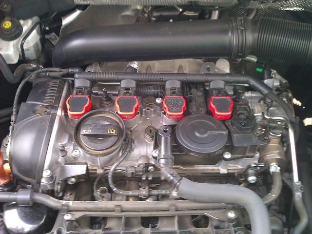

                              Just an update - I've had my set of R8 coil packs in and running for a couple of days with no issues. I can't say that it's 2 x faster but it does run pretty much same as before (no noticeable difference) which is what you'd expect.
