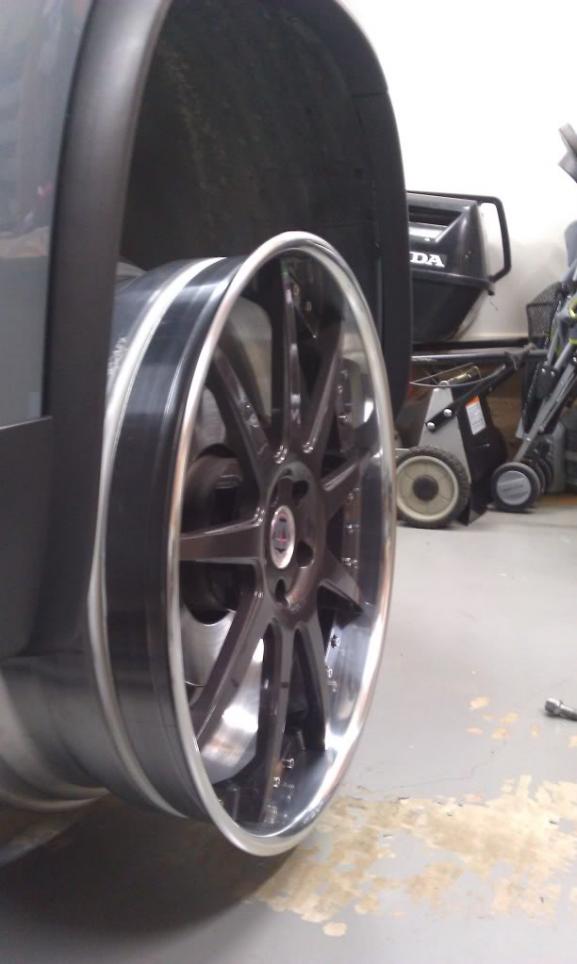

They are not Raderwerks wheels...
The company gave me such a great deal on the wheels, in return a photoshoot and some promo work for them. Until i get these wheels on my Tiguan i can't really say much about them.
They are custom made 3 piece forged wheels made in Miami USA, so yes they can be made to any specs you desire.
22x9 front
22x10.5 rear.
Staggered fitment would not be a problem (wheel engineer assured me), by the way BMW X6, X5, Porsche Cayenne all run staggered fitments.

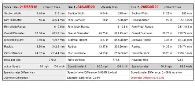

Still researching tyre sizes but l think we may go with 245-35-22 front and 285-30-22 rear.
