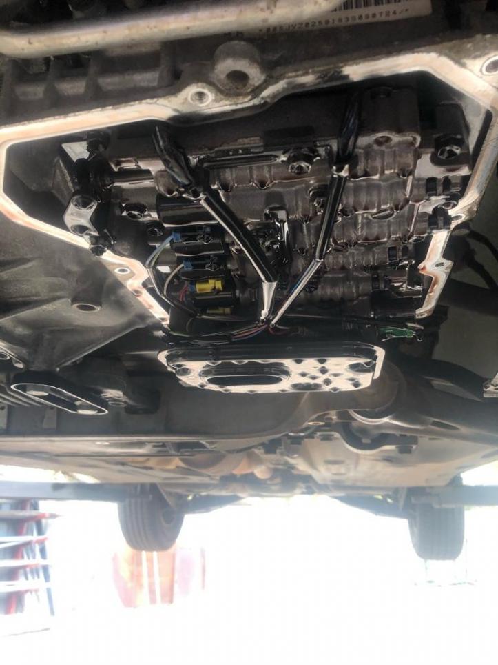

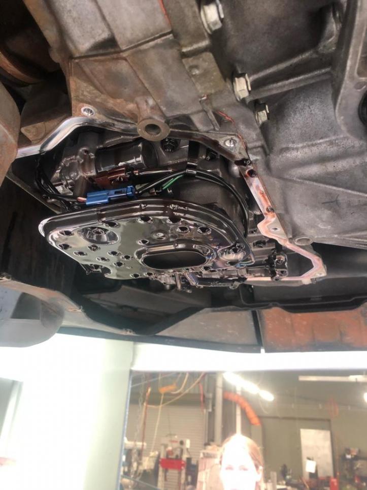

                  Have now changed ATF and filter. Got just over 4 new litres of Toyota T-IV into it. Quite an easy job using a $10 Bunnings pressure sprayer to push the new ATF in. I used a hand held heat gun to read the ATF pan temp with engine idling for the right fill level.
                  158k kms and the original oil was barely recognisable as being pink. The magnets in the pan were heavily coated with a few mm of metal paste.
                  As I’ve got 3 litres of new ATF left over the best bet would be in another few months to drain out exactly what I have new and refill since I know now the level is perfect. Will be close to a full change then.

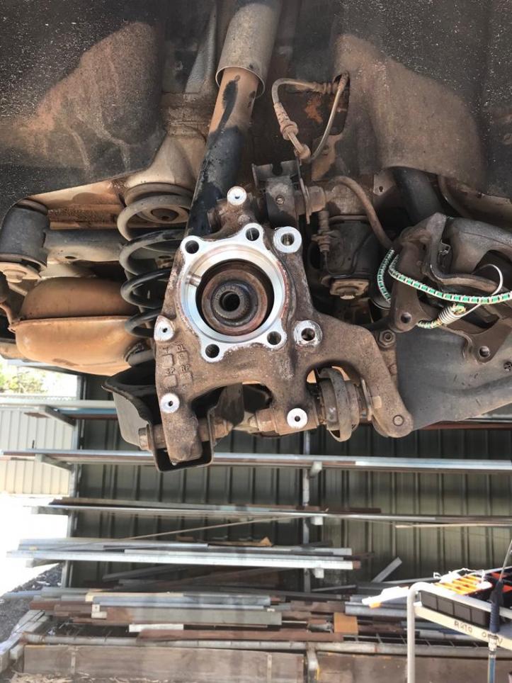

                            New rear wheel bearings and now silence has returned to the car. The drone was unbelievably bad above 60kmh.
                            Quite easy and did not have to remove any suspension components to get at the bolts holding the wheel bearing on.
                            Need socket extensions and a flex joint though to work around the drive shaft.
                            Also need the triple square 12 and 14 male sockets for the brake calliper and wheel bearing bolts.
                            And a big breaker bar.
