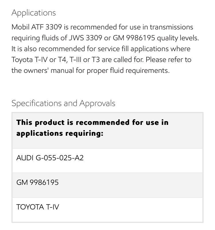

                          • #28
                            Originally posted by Lucas_R View Post
                            Oh yes seen it, thank you
                            • #29
                              Originally posted by Perthdisco View Post
                              With regard to ‘specialist’ advice that is the exact manufacturer problem. Is the gearbox ‘sealed for life’ until it blows up out of warranty or do you change the oil as preventative maintenance? With a torque converter you cannot physically remove all the oil by draining the sump, maybe 40% retained so you do the process twice in close proximity to achieve a higher percentage.
                              Are you are confident that the Toyota oil is the same as the VW oil? That is the problem & only you can decide if the saving is worth the risk. In my opinion, the oil should be changed at regular intervals. On the T4 that was at around 40,000 miles (in the USA] & even more frequently if towing. The T4 has a strainer/filter that should be changed & a magnet that should also be cleaned & will give you some idea of how things are going by the amount of steel whiskers. I don't know if the Tiguan has these. The oil on the T4 could also be changed from memory by undoing the level tube.
                              A friend of mine has a Mercedes Vito van that probably has a ZF box. He started having trouble & an oil change sorted that probably 2 years ago. Hope that helps.
                              Understand how it works, troubleshoot logically BEFORE replacing parts.
                              2001 T4 TRAKKA Syncro 2.5TDI,2006 Mk5 2.0TDI Golf manual,2001 Polo 1.4 16V manual [now sold], '09 2.0CR TDI Tiguan manual,
                              Numerous Mk1 Golf diesels
                              • #30
                                New to me 2010 Tiguan
                                Thanks yes the procedure of draining and filling is the same you describe.
                                Here’s the Mobil 1 recommend oil with equivalents on basis VW definitely don’t make their own oil.
                                This is basically the Aisin 6 speed gearbox ATF specification.
