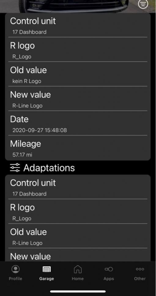

                Try this? This is from my Dad’s history.
                • All I can say is it was performed with OBD11 and under Adaptations not Long Coding. I don’t have access to his car any time soon. I don’t believe an Adaptation change will impact long coding values, case and point would be 09 controller is all Adaptations and Long Coding is all 0s since 09 no longer uses Long Coding for changes and when a change is made in 09 Adaptations there is no change to the Long Coding value. Maybe at the time on the Golf it was a Long Coding change, but the Gen 2 dashboard controller this change is now found under Adaptations.

                          I only changed the Adaptation on my Dad’s 2020 model and worked without an issue. If LKA is on and not in the dials, the R logo gets replaced by the mini LKA in the bottom center when driving.
