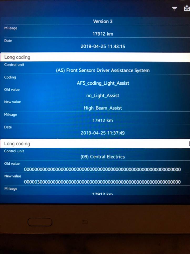

                          Ok so here’s where I deviated from the AutoInstruct guide:
                          I either did that instead of ticking the bytes, or I did it in conjunction with it... but I believe I did the former.

                              To clarify on my own post, I seem to have done this instead of the front sensor control unit byte.
                              • Have changed that but I guess I will have to try to recode the whole thing as after I got the 'Not supported" notice it looked like the settings I changed had reverted back to original. Will be using it ant night on Sunday so we will see
                                UPDATE
                                SUCCESS
                                Had to change a couple of things Like extra headlight LED and do what you said and it shows the correct symbol in the dash anyway, when I have headlights on and push the stalk away from me
                                couldnt figure out how to get the A5 to show in hex but worked out little sign in top of phone screen changes it into hex from English.
                                I changed it as you did but also did the hex settings and iit seems to have done it Now to see if it works on Sunday
