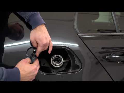

      I recently had this happen in my SQ5. It was still working but was making a straining/grinding sound and the actuation was delayed. I decided it was best to replace it while it was still functioning. Its quite common now that the cars are a few years old. You can do it yourself quite easily and save yourself nearly $300 based on that quote from VW.
      The part number and video below are for a Mk7 Golf, the current shape Tiguan may be similar or the same seeing they are based on the same platform/chassis. I would recommend removing your existing actuator to double check the part number before ordering.
      New Genuine VOLKSWAGEN GOLF POLO JETTA Fuel Filler Actuator Flap 5C6810773K OEM | eBay
      NEW GENUINE VOLKSWAGEN POLO JETTA FUEL FILLER CAP ACTUATOR FLAP 5C6810773K | eBay
