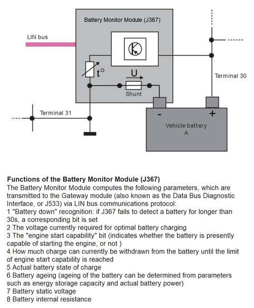

    Here's a diagram showing how J367 is connected:
    As you can see, J367 is a LIN slave to the "Data bus diagnostic Interface" module (this is called "J533") and it happens to share this communications wire with the same wire that the alternator uses to talk to J533.
    So, the fact is that J367 does indeed have multiple roles on MQB platform vehicles (like your gen2 Tiggy); it's primary function is to provide a constant stream of real time data about the battery (via the LIN comms line shown above) to the car's Energy Management System (EMS). This data includes (but is not limited to) Battery voltage, Battery temperature (the EMS uses an algorithm for this) and a complete history of electrical current drawn from the battery and injected into the battery over its life cycle. This data stream is used by the EMS to make decisions like:

    The reason why pulling the connector from J367 is the (supposed) fix for SS is that the EMS has no information about this part of its decision making role, so it thinks the there is insufficient battery capacity to re-start the engine.
    And, the reason why it's vitally important NOT to connect the negative battery cable from a jump-start battery, or battery charger directly to the negative battery terminal of the car battery is because it by-passes J367. If J367 is by-passed, it means that the EMS does not measure the amperes being injected into the car battery by the external device - which in turn means that the true history of the battery is lost - which means that the EMS cannot correctly modulate alternator charging current over time to optimize battery longevity.
    So, as I have suggested, J367 is part of the car's wider energy management function and removing the data stream is NOT a trivial matter, or a matter that affects just SS.
    My suggestion is to replace the connector immediately so that the battery history file on the EMS is not further corrupted. If you want SS disabled, do it properly via a tweak from a diagnostic device, or install/make an auto SS kill switch (I've designed a few which you can find on the Golf mk7 forum)

                        Finally, below is an extract from a post that I wrote on the OBD11 forum regarding J367 - which I call the "Battery Monitor Module" (BMM). Hopefully it will help in your understanding of this matter - ignore reference to mk8, the dialogue is equally applicable to your mk1 Tiggy
                        This is a diagram of what's inside the BMM and what information the data-stream provides to the car's EMS - I thieved this picture from a
                        MQB platform car -but I expect that it is equally applicable for a MQB-evo vehicle like a mk8 (note the BMM is called J367 in the VW wiring diagrams):
                        As I have said, I suspect that the LIN facility in the diagram above is replaced by a pair of CAN wires on a mk8 and I expect that on this 2nd generation version of the BMM, the functions that use the battery information stream is even longer!! However, my assumptions about a mk8 notwithstanding - what's clearly evident from the function list above is that the BMM data-stream is pivotal to a wide range of EMS decisions - extending well beyond the SS facility
                        I've argued in other forums that deleting the BMM data-stream from the EMS must affect the performance and longevity of the battery on cars that have SS. These EFB/AGM batteries use more sophisticated manufacturing methods than normal flooded-cell techniques and they require more disciplined charging regimes to maximize performance and battery life.
                        Notice the Shunt resistor in my diagram above - this component of the BMM measures EVERY milli-ampere of electrical current that is either drawn-from, or injected-into the battery over the life of the battery. So, together with the Battery information that the hex19 module stores as adaptation channels when the battery is installed into the car, the EMS maintains a complete history of battery capacity and it uses this historic data to adjust the optimal charging profile for maximal battery longevity! When the hex19 module is told that the BMM is not installed (via this tweak) - this entire data-stream is lost to the EMS!!
