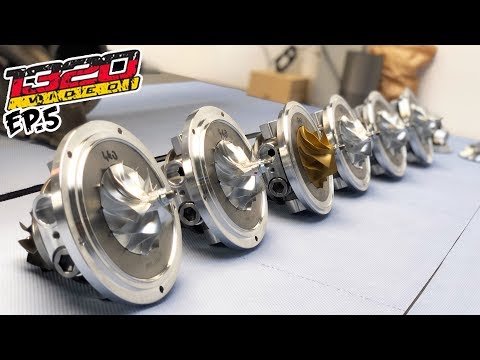

                      Watched this video last night of a turbo modification factory in Germany, lots of Golf MK7 turbos in their factory for rebuilts and upgrades. Mentioned TT500 turbo for the MK7 which they are working on.
                        Maybe your Tig was adapting to the the mods, that is good news about CEL, fingers crossed for you.
                        A hybrid IS38 would be amazing on the Tig, 500 HP would be pushing the limits of the stock engine. Although The Turbo Engineers have a number of hybrid turbos including the TTE610 which is rated upto 620HP fot a GTI or Golf R.
                          Yeah but we get the DQ500 which is a big plus. There's definitely a limit to how much boost you can run with stock internals though.
                                MRC in the UK are running 600hp hybrid turbos on stock engines (with meth though), gotta wonder about how long they last till they go bang...
                                An OEM+ Stage 3 Tig (or any is38 hybrid) would be crazy!
