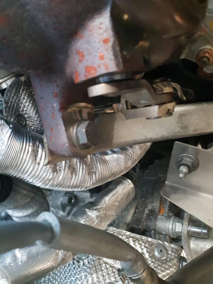

                        I found my rattle, it's the tip of the wastegate actuator rod and the wastegate arm. This morning when I started it, I quickly held it and there was no rattle. In my photo you can even see that the design allows for too much movement. Also before starting I tried wiggling the actuator arm and there is virtually no play. Just need to work out an easy fix, anything expensive fix will just push me into is38 swap.
                        Sent from my SM-G965F using Tapatalk

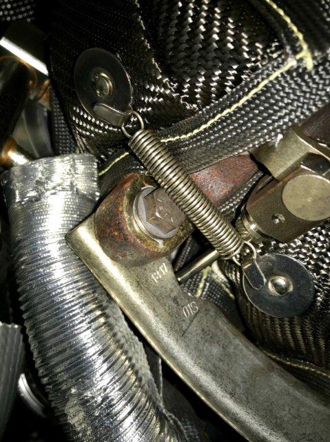

                              ... You could always fit a small metal spring (or similar) from the wastegate arm back to the firewall/engine, just needs to take the slack in the arm and test if this it the source of your rattle?

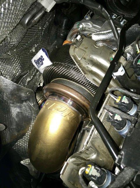

                                A few pics of the Turbo Blanket... The small spring over the top of the wastegate arm is actually what appears to have stopped the ‘rattling’... The spring is soft and doesn’t impede/restrict the movement of the arm and it’s designed for these temps too so it’s a safe solution if this is the source of your rattle!
                                Any questions let me know! Cheers
