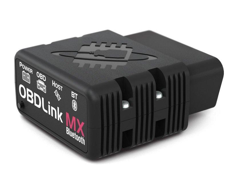

    I used an obdII device connected to my mobile to check live temperature.
    Was pretty good and easy to set up.

      That looks good. Will check it out. Saves running wires etc. Thanks.
        Don't go for really cheap one. As you don't want to damage ECU.
