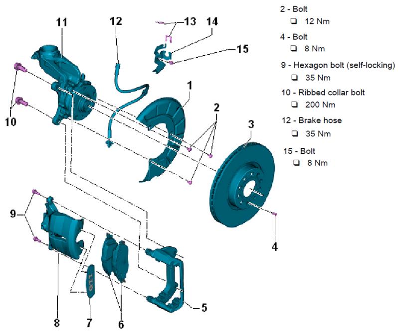

    Hi - I have been looking around for specs on torque settings for the front calliper mounting bolts and slide bolts. I have seen various settings mentioned - 190Nm to 200Nm for main bolts and 30Nm to 35Nm for slide retainer bolts. Also, are any of the bolts torque to yield bolts ?
    The vehicle is a 2017 Golf GTI Mk7 with performance pack (40th anniversary) with the 340mm brakes.

      Thanks - a few more questions.
      Wheel nuts ? 120Nm ?
      Are any of the calliper bolts torque to yield bolts ?

        Wheel nuts ? 120Nm ? -Yes
        Are any of the calliper bolts torque to yield bolts ? - not sure, but VW advise "Renew self-locking hexagon bolts for securing brake caliper."

            Trying to find a part number.
            Pretty sure they are either #5 or #10 (or both) but the part number listing for #5 and #10 is the same yet they are differnet size bolts and even in the diagram below they are different sizes:
            [ 5 ] FRONT SUSPENSION / FRONT SUSPENSION / BRAKE COMPONENTS / Caliper mount bolt
            Part Number: WHT003250
            [ 10 ] FRONT SUSPENSION / FRONT SUSPENSION / BRAKE COMPONENTS / Caliper mount mount bolt
