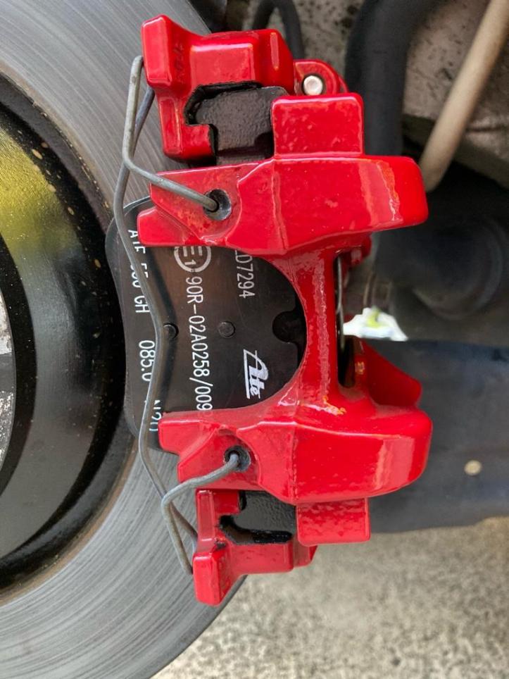

                      I just fitted ATE Ceramic pads to my Mk7 GTI Performance and am extremely happy with them. Mainly wanted them for the low dust factor of the ceramic compound combined with the lower disk wear rate.
