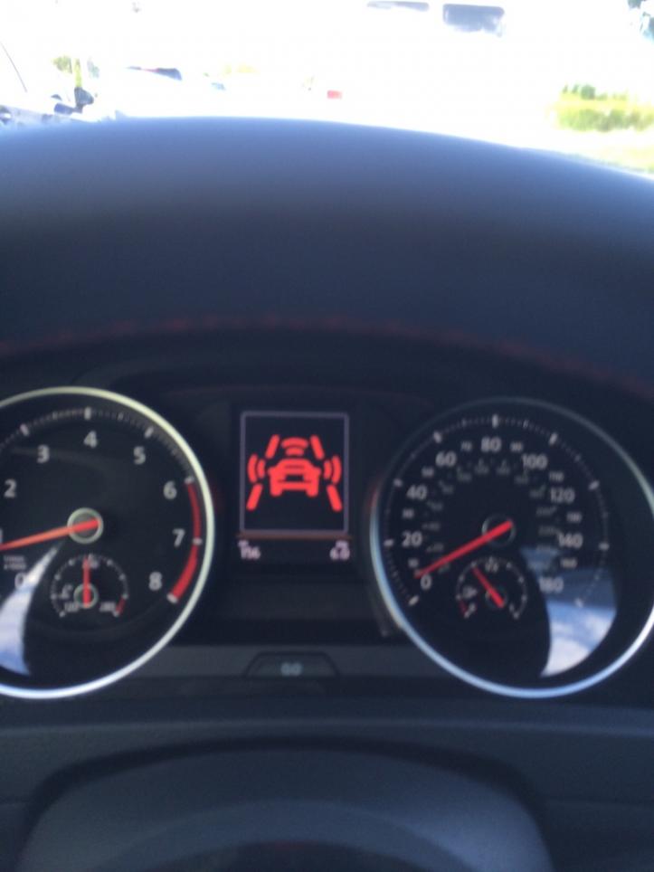

                  Picture is from vwvortex forum post 46. Thanks to jleao1 for posting pictures with explanation. Link VWVortex.com - First MK7 Autobahn Manual /w Driver Assistance Pck (U.S. Spec)
                  Originally posted by agentthumb View Post
                  The image on the right is the only thing I've seen when the system has alerted me to brake.
                  @MRG_AU, I stand corrected. Saw the symbol you described today in the MY15 Golf (it picked up a car turning left slowly). I think the symbol changed with DAP2 as it's definitely different in the MY13 with DAP1
