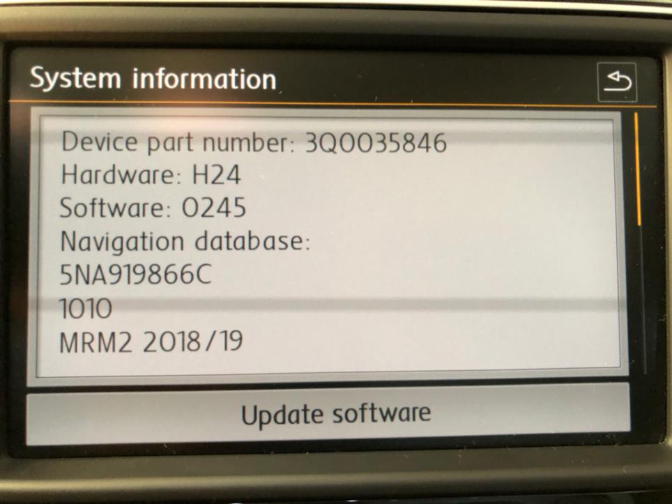

                          • new maps installed successfully.
                            Sent from my iPhone using Tapatalk Pro
