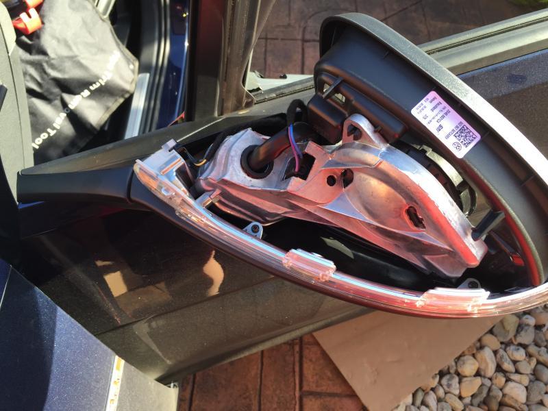

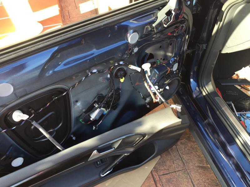

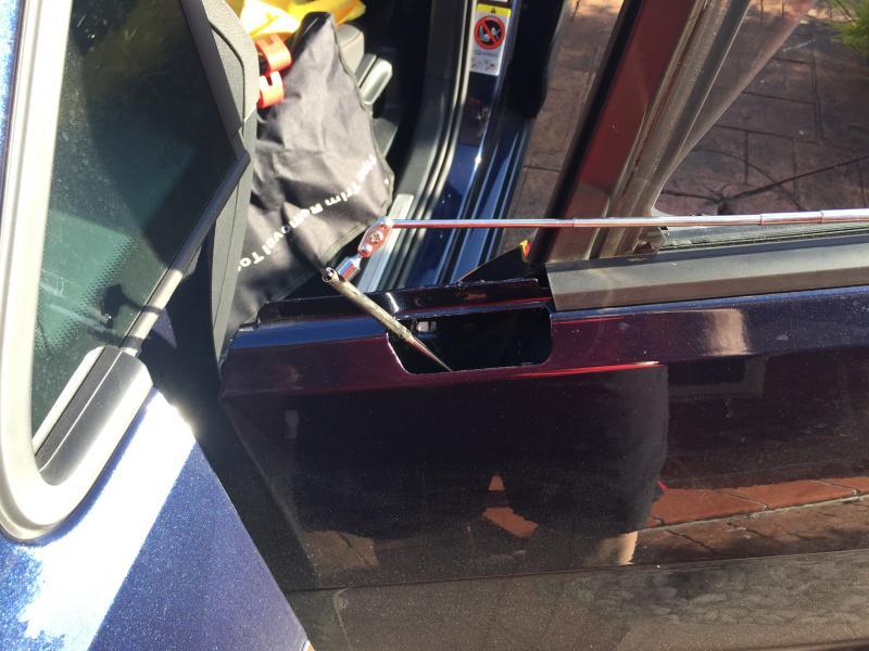

          Hooray in an finally working.... On the Performance Pack the controllers were required (can't speak for the standard GTI).
          The part numbers are correct Booba provided.
          Left Mirror 5G2 857 507 CA 9B9
          Right Mirror 5G2 857 508 AJ 9B9
          Switch 5G0 959 565 AA ICX
          A couple of things to the note the instructions from USP Motor Sport are correct. But the wiring to move the door skin on the drivers side is a little more fiddly ...I was upside upside down looking up the door..... you don't need to remove the door skin completely on either door (the door handle cable) just lay some cardboard down so the skin does not get damaged. Routing the cables can be a little difficult but if you get the grabby thing from supercheap auto and a magnet then is to hard.
          Important One thing to note..... do not try and fold the mirrors manually they are not spring loaded like the factory standard mirrors. You must use the Switch or the keyfob to lose them or you will break them. I followed the coding from USP motor sport not sure if Booba can add anything here. The manual says go to the Car Setup Mirrors but I can't see any thing will have another look tomorrow to Auto close them on lock.... I have to hold the lock button on the Fob for them to close or use the switch. Video and PICs attached. Last pic is the video.
