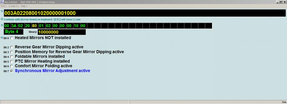

                        peekay: Isn't V121 in my previous wiring diagram the motor for the fold-in function (incidentally, I added the standard mirror to the diagram for reference)? As for the "smarts in the door controller", I assume that all that is needed is to activate bit 4 and bit 6 of Byte 4 in the door controllers- see pic below. Is my assumption incorrect?
                        I'm also assuming that the extra switch for the fold-in mirrors will not be a problem because E263 in the diagram below is simply part of the whole switch assembly. Am I wrong?
