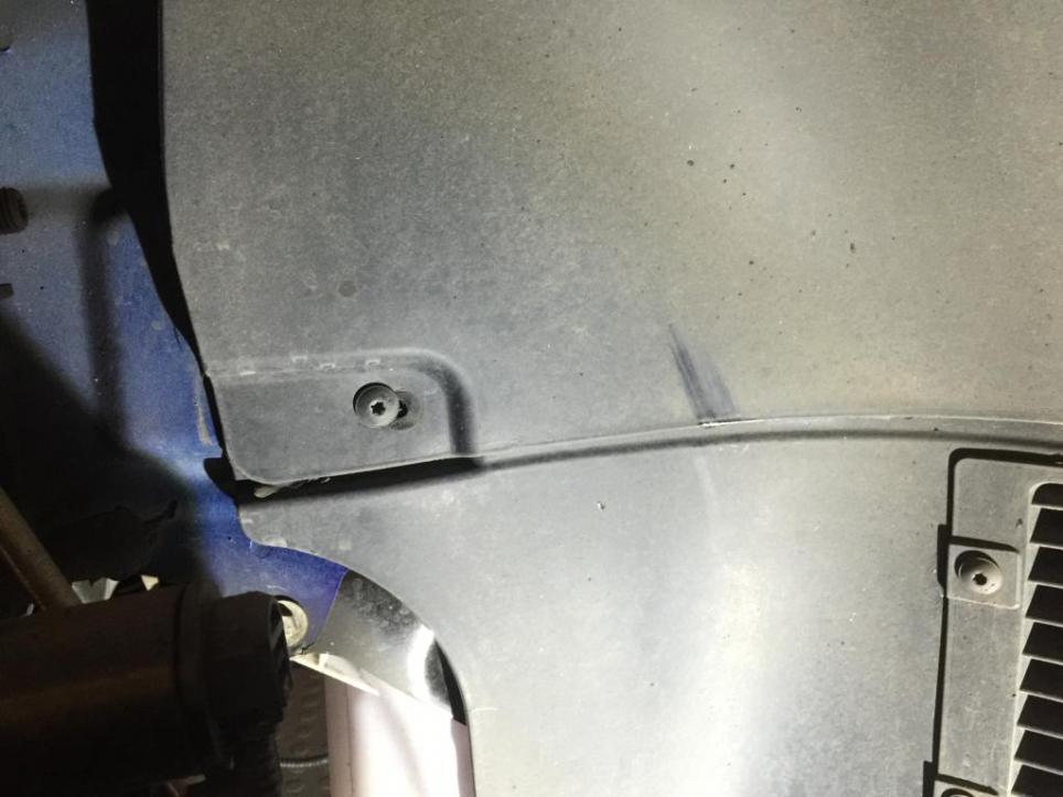

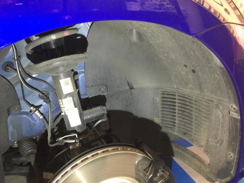

    hi guys I've noticed wheel rub at full lock even though I went for the oe spec borbet lw 8x19 et 50 wheels and 235/35 tyres on my R,I'm wondering do vw put steering lock stops on like ford do at the factory if 19" wheels are selected? Because my uk R had the standard 18" Cadiz wheels from new,going to take the wheel off later and see whats rubbing.
    sorted! I took the wheel off and found the liner just needed a simple adjustment via the torque screw shown in the pics,sliding the liner to the other end of the screw slot moved it in where it was catching by a good 12mm.
    • Good catch and thanks for documenting that for the thread.
      I'm unaware of any differences with the R on the Mk7, there was definitely a modification to the amount of steering lock on the Mk6 Rs here that came with 19s which was why most dealers would not swap 18s and 19s on stocked cars.
      The GTI PP is unlikely to be affected on its 19s as it is only x 7.5 wide - another great reason to ditch the Santiagos and get something a little more aggressive (and better looking).
