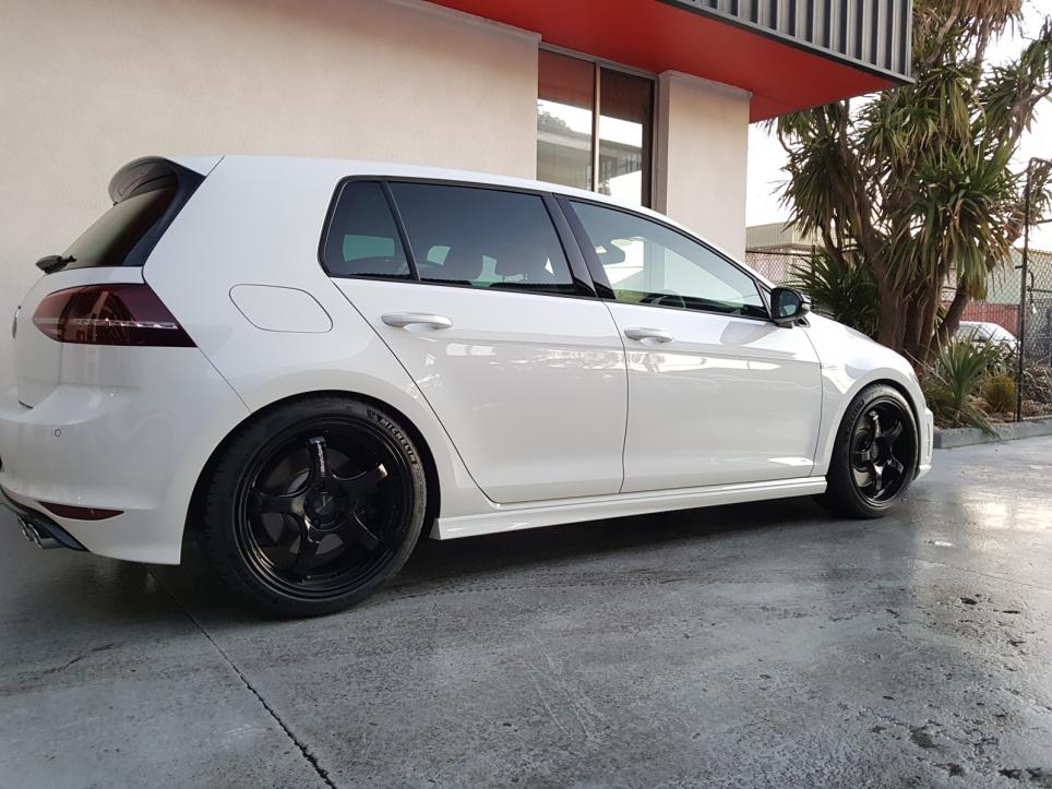

            • Any guesses on my new 18’s before I post pics tomorrow?
              They’re 18x8.5 ET45... I was tempted to get some OZ Superturismo LM’s, but they’re damn expensive and only 18x8, so went a cheaper option instead (again)
              2006 MkV 2.0TDI -> 2005 MkV GTI -> 2008 MkV R32 -> 2013 Polo 77TSI + 2016 Mk7 Golf R Wagon
              • Originally posted by shauno View Post
                I was thinking BBS SR but then they're only 18x8. So my next guess is Rotiform BLQ.

                • Correct on the Rotiform, but I don’t like the BLQ
                  Close on the BBS idea too [emoji41]

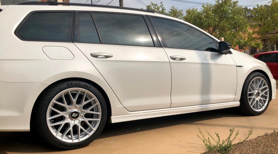

                  • OK 3rd guess Rotiform FLG??
                    - Tigger73's 125TSI Build
                    • The Official Mk7 Wheel Thread
                      Nope - I think maybe Dutch could have guessed, as I’d talked about these before...
                      Rotiform RSE
                      The move from 35 to 40 profile is lush, it’s so much more forgiving on potpoles and speed bumps!
