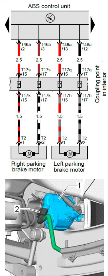

      Can be done with a battery and two wires, one way opens the pistons and reverse wiring closes it
        Hmmm...... never done it this way - but I guess it's technically feasible (yes, DC motors reverse direction if the applied voltage is reversed -this does NOT happen if the wires are reversed on an AC motor)!
        However, if OP decides to use this suggestion, maybe a few issues to consider - this is the wiring arrangement for the EPB motors:
        • Notice the numbers on the wires on the factory loom on the upper part of my picture (i.e, the wiring diagram). These EPB motors draw a hefty electrical current - "2.5" in my picture means a wire with a cross-section area of 2.5 square millimeters. To give context to this number - these wires are an order of magnitude fatter than the normal signal wires in the car! The temporary wires need to be at least of equivalent size
        • Also, access to the terminals on the motor body requires disconnection of the connector -2- on the lower part of my picture. This is a good thing because, you do NOT want to back-feed voltage into the ABS control Unit when using this technique. As I said, the amps that will flow will be not insubstantial - so make sure that the temporary connections are robust (both at the battery end and at the the EPB motor end. Plus, I suspect that the monitoring facility in the ABS module will not be happy when connector -2- is unplugged and an error message might be stored in the module fault memory (not sure?). If so and ironically for a technique that avoids a diagnostic device, a diagnostic device will be needed to clear this error message
        • And finally, the ABS Brake module in this car contains a kind-of short-term backup power-supply that the driver can use to operate the brakes if the primary wiring loom from the battery is severed in a collision (it's a largish capacitor) So allow the capacitor in the module to discharge before starting this technique - switch OFF ignition for at least 30 seconds before unplugging connector -2-
