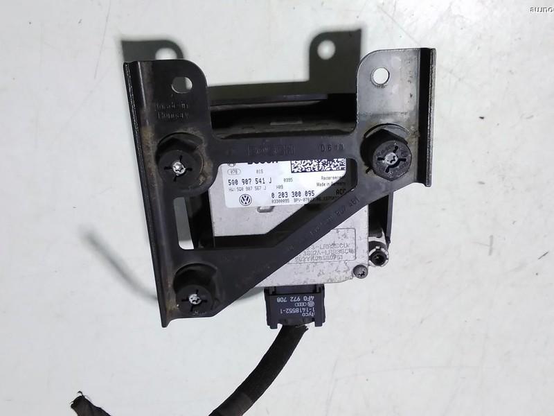

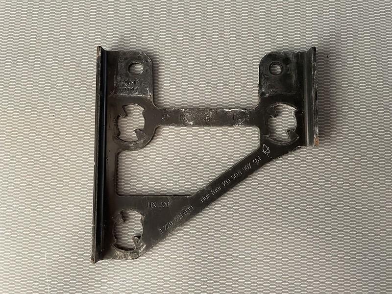

      some of the parts have arrived, first up the bracket. it's missing the levelling screw etc but I suspect I might end up with another when I buy a radar anyway. I just wanted this to use as a template to drill the crash bar...

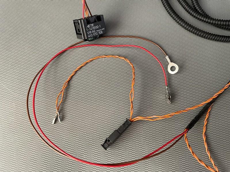

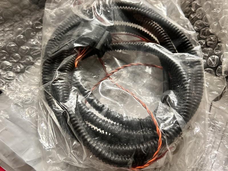

      next was the wiring harness which I'm very impressed with for $40. it comes with all the loom tape and split conduit...
      it also comes with a splitter for connection to the can bus so I can de-pin the existing then plug in to the splitter plug...

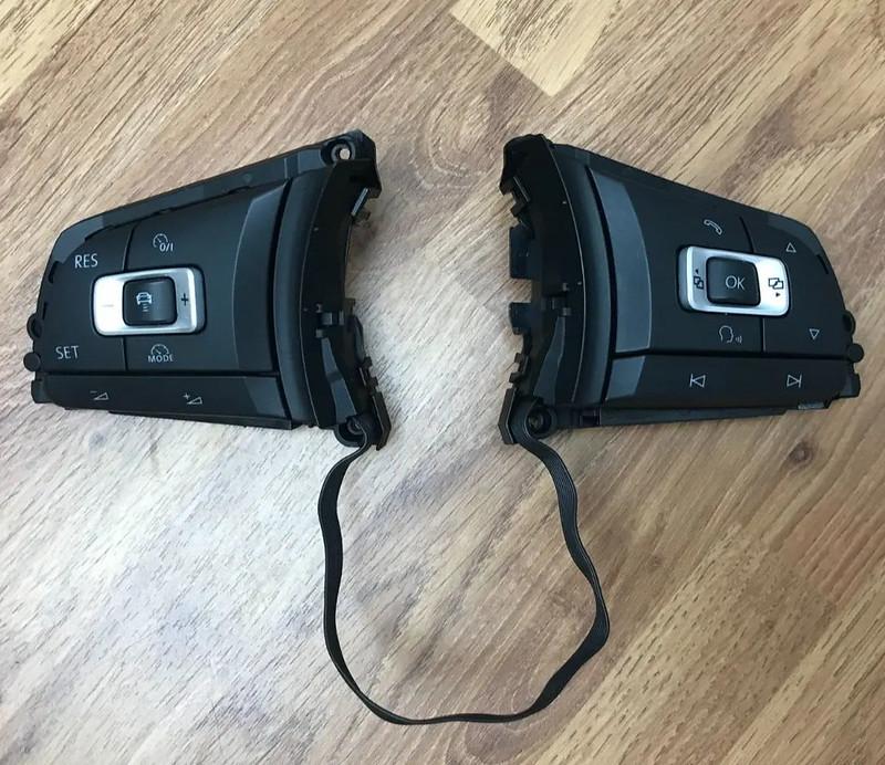

      steering wheel switches, not cheap. hard to get hold of in the correct part number, I ended up getting these from the UK...

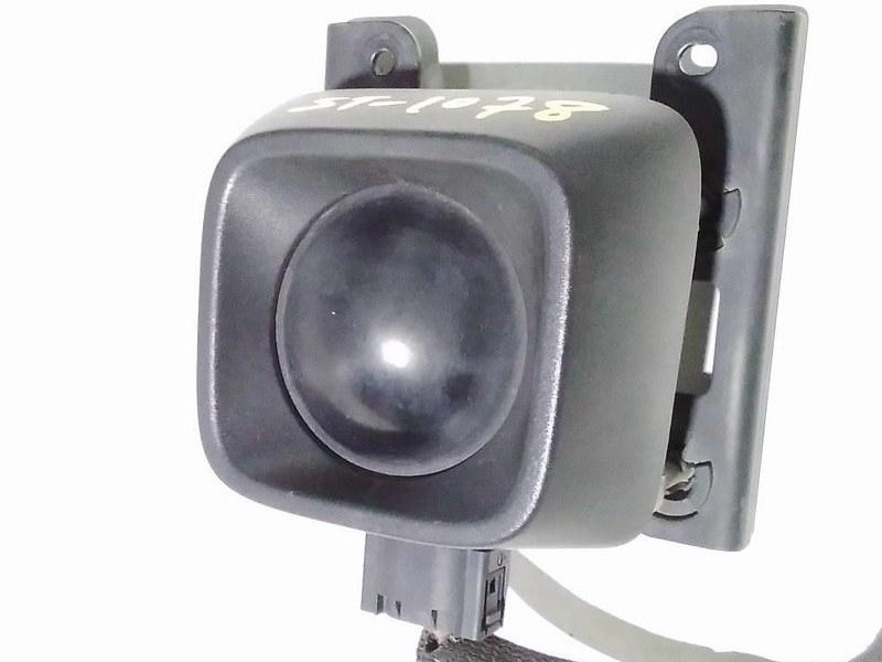

      radar, also not cheap but feel like I got this at a good price and from Australia so not suffered the bad weather...
      as suspected it came with the bracket and face cover which is good. I might try and cut the other bracket down and use that as the face plate between the bumper and radar bracket...

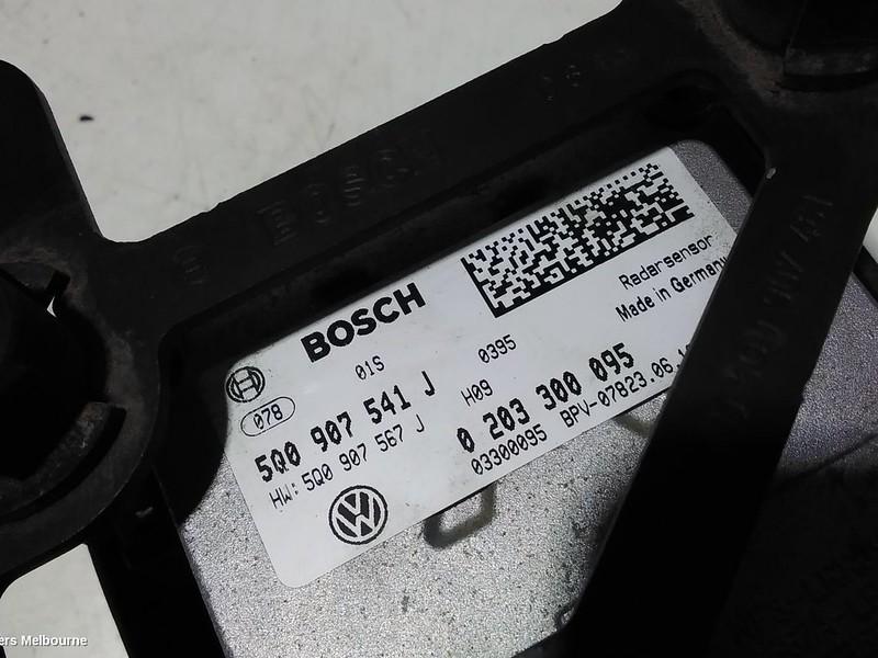

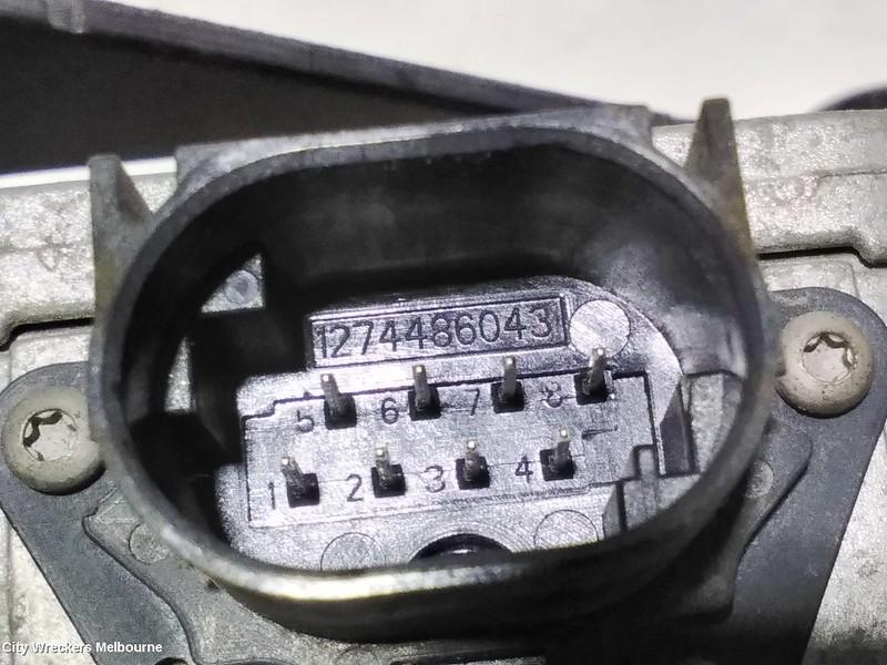

      its a revision J which I haven't read much about however I'm reliably informed it supersedes revision G so lets hope it works...
      looks like it has the correct number of pins which is a good start...

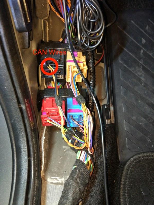

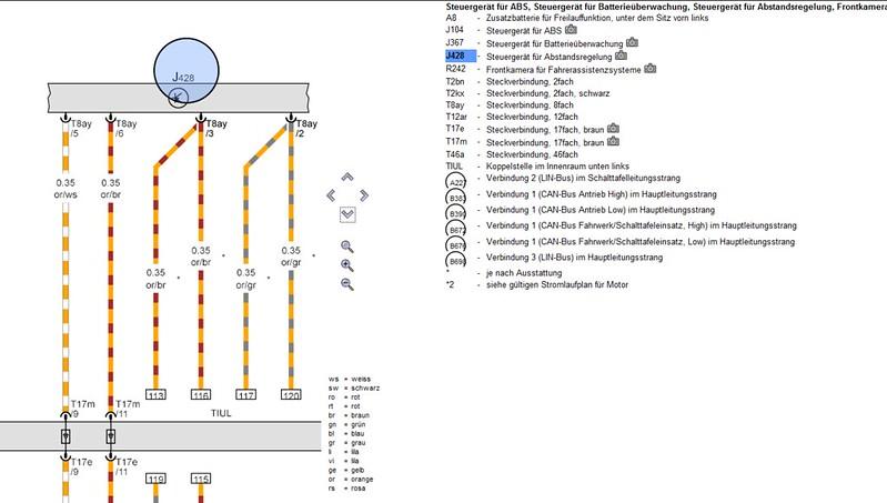

        my plan for the first stage is to get what I think is the hard part out of the way. drill and fit the radar mount and new grill surround then run the wiring harness from the mount to inside the car via a grommet behind the battery. this will bring the harness in to the cabin near the glovebox and access to the can bus wires at the tiul connector...

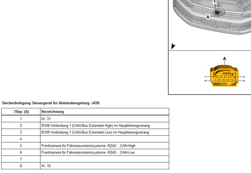

        the wiring should be pretty easy and I'm fairly confident the below wiring diagram and colour coding is correct. I'll use a fuse tap for the red power wire and a decent ground on the body for the black wire...
        tiul wire colour coding on the left to the radar harness pin out on the right:
        Or/Gr -> CAN-Bus Extended High -> Pin 2 on Radar
        Or/Br -> CAN-Bus Extended Low -> Pin 3 on Radar

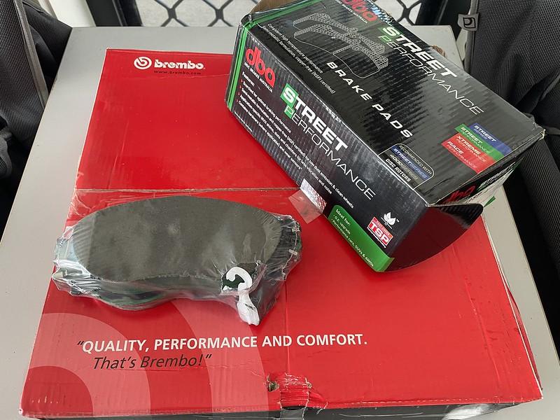

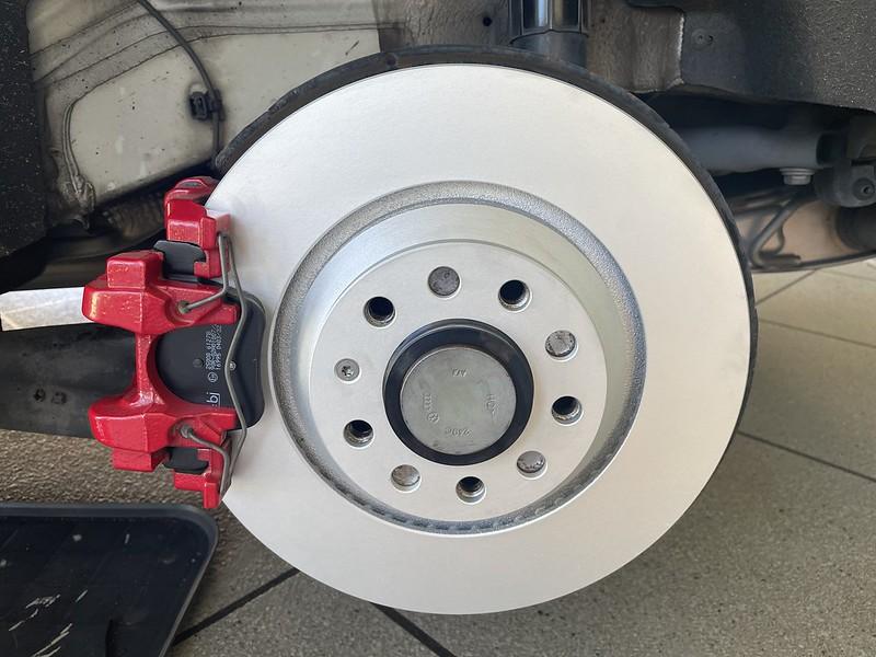

                  with extra power I decided a little brake refresh wouldn't be a bad thing, not big but just some better discs and pads on the front. I went with the budget option of brembo grooved and dimpled discs and dba street performance pads...
                  and just standard Bosch discs and pads on the rear...

                    Nice, those pads are on my list for when I need new ones. How do you rate them? What did you have on before?
                    I actually put a set on our Triton this morning, but I can't tell so much in that vehicle.
                    I really like my stock pads and I have heard these will have a similar feel.
