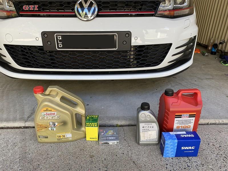

its due a major service soon and the previous owner was kind enough to send me a photo of service products he used previously...
I'm posting it here as a reminder what to order...
Plus brake fluid change, Penrite Brake Fluid Super DOT 4...Last edited by guile; 26-07-2023, 07:56 PM.

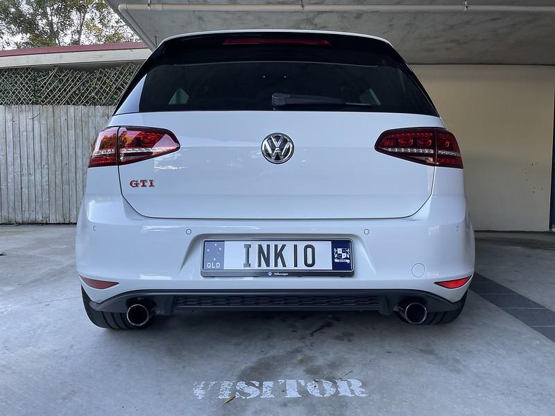

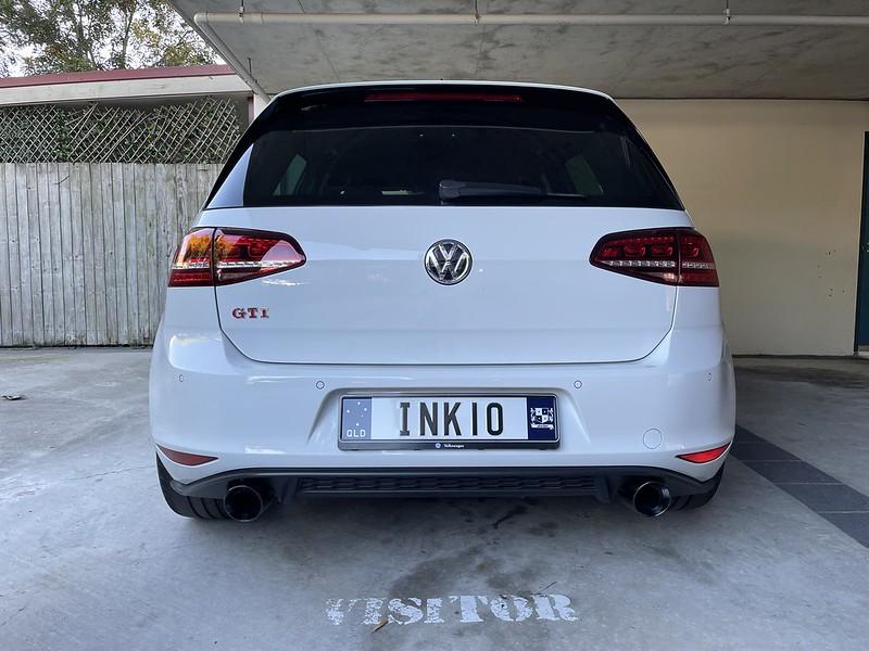

fitted some slip on exhaust tips, before photo...
after photo. not a major difference but it was the look I wanted so I'm pretty happy with it...
and you can't really tell from the from the back or side view unless you look hard enough...
thanks mate, just some cheap ones off aliexpress...Originally posted by Lucas_R View PostLooks good. What exhaust tips did you use? Are you enjoying the GTI so far?

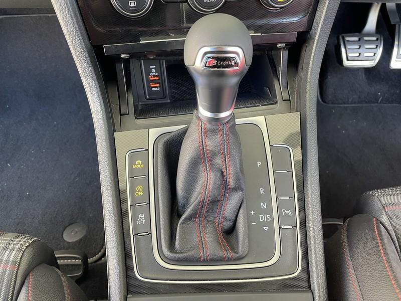

Changed the shifter and swapped out the usb ports…

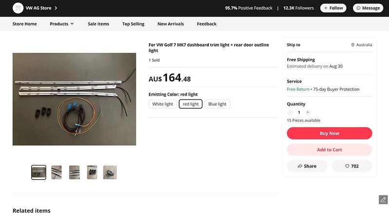

looking for the next interior mod now. i've tried to do some research on updating the rear door card and dash lighting with limited luck on detailed info...
has anyone had experience in doing this. below is the kit i'm thinking about buying...

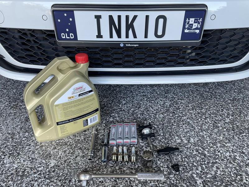

my first oil change on a mk7. what a piece of cake, it couldn't have been easier. looks like it was due too...
I wish the same could be said for the plug change. what a wrestle trying to remove the coils, I thought I was going to pull a couple of them in half until they finally let go...
next is gearbox and diff which I suspect is not going to be much fun either...
I've read that is easier with the engine warm (but be careful not to burn yourself). IIRC there is a special tool for pulling the coils off the spark plugs.Originally posted by guile View Post
I wish the same could be said for the plug change. what a wrestle trying to remove the coils, I thought I was going to pull a couple of them in half until they finally let go...2017 MY18 Golf R 7.5 Wolfsburg wagon (boring white) delivered 21 Sep 2017, 2008 Octavia vRS wagon 2.0 TFSI 6M (bright yellow), 2006 T5 Transporter van 2.5 TDI 6M (gone but not forgotten).
my first venture in to the mk7 club...
Yes the oil changes are nice and easy - no need to remove oil pan cover etc. I never fully trusted the weird sump bolt....but it never leaked (always used a new one).
As for the ignition coils, yes they are a pain to remove but as mentioned above, its easier if the engine is still warm.Last edited by Lucas_R; 22-10-2023, 06:22 AM.
Originally posted by gregozedobe View PostI've read that is easier with the engine warm (but be careful not to burn yourself). IIRC there is a special tool for pulling the coils off the spark plugs.thanks for the feedback. the engine was still warm from the oil change and the plug puller tool is just to the right of the spark plugs in the photo...Originally posted by Lucas_R View PostYes the oil changes are nice and eay - no need to remove oil pan cover etc. I never fully trusted the weird sump bolt....but it never leaked (always used a new one).
I didn't really need the tool as the top of the coil came away from the valve cover easy enough. it was the rubber boot that felt welded to the spark plug ceramic way down the hole. it literally stretched about 50mm before it let go, I thought I was going to rip the boot...
I think its maybe caused by years of heat cycles and eventually welds on. I did spray some lubricant inside the rubber boots to try and prevent it happening in future but I guess it will evaporate over time...
I used a new sump plug from VAG and also bought the removal tool as I hadn't used one of those plugs before and wasn't sure how it worked. an Allen key of screwdriver would have probably been just as good...
