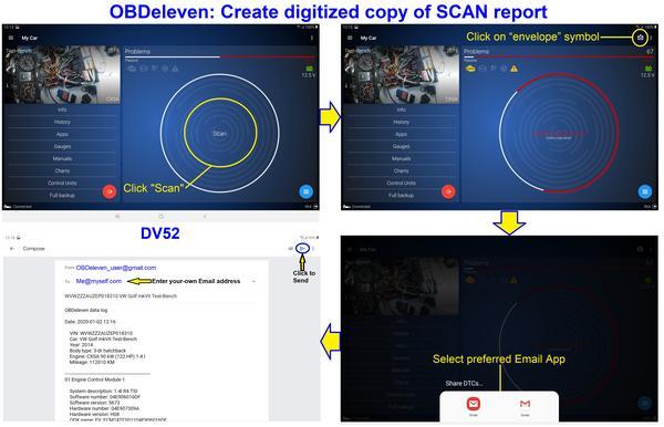

          PS: in respect of "5" above and assuming that you run the OBD11 software on an Android device, this is how to digitize the scan report - which can then be included in a forum post:
