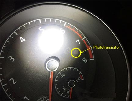

      As you may be aware, illumination of the the instrument cluster clocks and lot's of other switches via the T58 supply is controlled by a photo-transistor that sits between the "7" and "8" numbers on the rev-counter (see picture below)
      Grab a torch and shine it into the area shown, the clocks should increase in intensity (as should a number of back-lit switches inside the cabin.
      The job of the photo transistor is to modulate the value of the T58 voltage-rail according to the ambient light levels inside the cabin - so at least on a mk7, no there is nothing normal about a 12V T58 rail!!

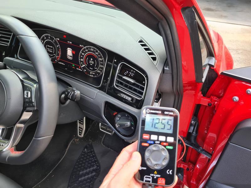

        I did a quick multimeter test yesterday at a friends house and I was sure we saw 12v with the car having the lights on, using the dial, and minimal mv with it off. Typical behaviour.
        At home last night at dusk so the car was in auto lights night mode the best I saw was that 7v to start and now I see it goes down from there, and the gauge seems ok until it goes below 4v. Who knows how low it might go, and what for? It certainly seemed to be on nothing but a downward spiral.
        Here is a pic from yesterday when after maybe 10mins it had gone to 4v and I decided to take a photo and then go for a drive, but then it hit below 4vand I saw the fluctuations start.
        So just now I went out again in good daylight and lo and behold, we are getting a full 12v, as I thought I remembered seeing yesterday in the day.
        In night mode at dusk I could never see 12v on any setting on the dial.

          @genebaby:The readings don't mean much unless you describe precisely where are you measuring the voltages - explain where both meter-leads are connected (please)

            Hi Don, the reading are done thusly: Negative probe on ground, positive is touching the dimming wire.
            I'm not blaming the gauge, I was before I took these readings. It seems to handle the voltage being 4V and above, I did not beleive my car could be the cause. The gauge doesn't draw anything from that wire, it's just sensing the voltage for dimming functions.
            As it stands, my car shows different behaviour in the day and the night, and if it was reversed it would actually be ideal, as it reads a solid 12V in daylight, and was 7V and going lower at night time.

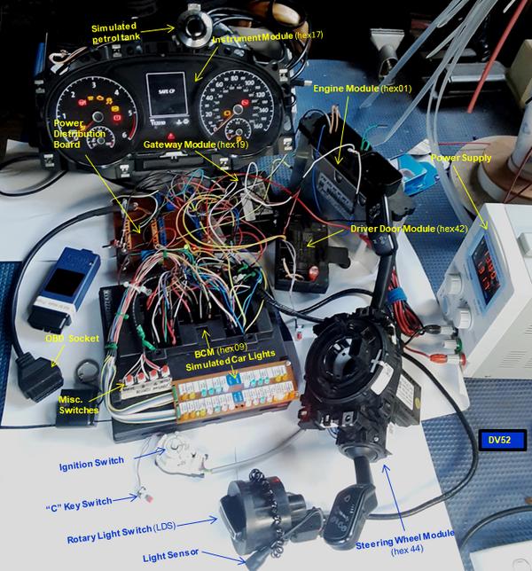

              @genebaby: Alas I won't have access to my car for a while (lent it to a friend)- but I did check the voltage on my "Virtual" mk7 - which is the spaghetti mess in the picture below:
              So, forgive the techno-babble that follows - but there just ain't any other way that I can explain this stuff: As I said in my earlier response, the T58 rail on a mk7 is generated by the BCM (pin #62/Socket C) and it's value is modulated by the photo-transistor in the hex17 module (I suspect that the dimming signal is communicated to the BCM as a CAN message - but I'm guessing). And... as has been pointed out by @Umai Naa!! - the method that is used for dimming is PWM.

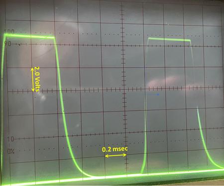

              With this as background information, here is a picture of the T58 voltage trace on pin #62/Socket C of the BCM on my test-bench - Alas, I had to use an old-fashion Cathode Ray Oscilloscope - it's all that I had in my workshop when I took the picture:
              Notice the characteristic PWM waveform - it certainly isn't anything like a DC voltage!!
              If you count the vertical axis lines on the screen -the ON pulse has an amplitude of 13.8 Volts (which is the value that I have set on the power-supply for my test bench) and the "Duty Cycle" of the waveform is about 30% - which means that the T58 voltage is energized for less than a third of the total time.
              Now a good, laboratory grade multi-meter should read about 13.8/0.3= 4.6 volts if set on DC volt-scale - but "domestic" multi-meters often don't like seeing the PWM frequency when asked to read DC Volts. (incidentally, the PWM frequency for the T58 rail appears to be about 800 Hz from the screen shot - count the horizontal axis lines).

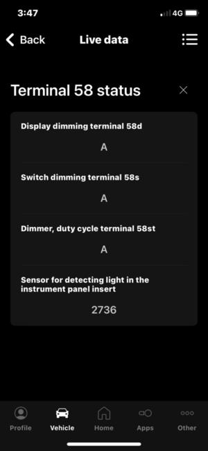

              Finally, I also had a look at what information was available on the hex17 module about the T58 dimming function. At least for the dashboard module on my test-bench, it is possible to select Terminal 58 status in Live Data - like this:
              I'm not sure what "A" means in the screen - but if I shine a torch into the photo-transistor, the value of "sensor for detecting light........." drops dramatically. So clearly the number in this metric is responsible for the dimming function (I guess).

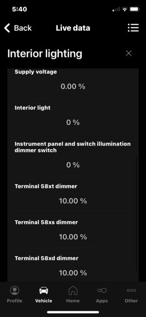

              Finally lastly, there is also information about the T58 rail in Live data in the BCM (not surprisingly). For example, if you select Interior Lighting, this is the result:
