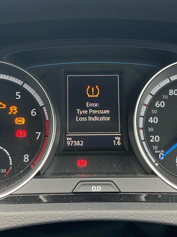

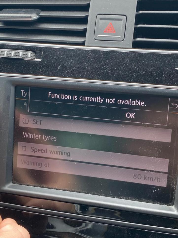

    Hi guys, hope someone can help.
    My TPMS light is stuck on. Had my local VCDS equipped mechanic have a look and the car is saying all pressures are fine (36psi all four) and that the light isn't on - BUT IT IS!
    Tried turning TPMS on/off in EBDEleven, no good.
    Reset TPMS in dash control - no good.
    My mechanic suggests someone could provide the original long code info for a 2016 GolF R Wolfburg wagon here in the forums, from which he could see in the code on my Golf what has changed.
    Can anyone help?
    Thanks in advance.

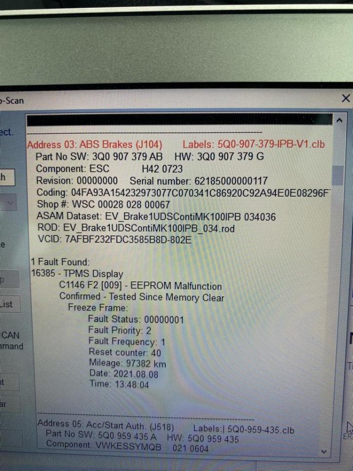

            Here is the coding from the ABS module on my 2015 Mk7 GTI. Hopefully it helps. Not sure why the forum is putting a space in between the 8 and the 4250BBC289 about 10 characters from the end, but there is no space there.
            01FA93A154272972077B060241CB6980C92A94E0608296F718 4250BBC289

              @mr200sx:hmmm....... I hope that replicating someone else's TPMS settings work for you - but if it doesn't, perhaps sharing the back-story for this fault might help. Why did the TPMS error message appear in the first place?
              AFAIK, there are 2 x separate modules implicated in the TPMS facility;
              • The hex03 module:
                • The software switches on Byte 27 - specifically Bits 4-6 (depending on the PR options fitted to the car)
                • If a TPMS button is installed - Byte 28, Bit 7
              • The hex5F module:
                • IDE04307-ENG117704-Vehicle function list BAP-tire_pressure_system_0x07 > activated
                • IDE04307-ENG117705-Vehicle function list BAP-tire_pressure_system_0x07_msg_bus > Suspension data bus
                • IDE04300-ENG117541-Vehicle menu operation-menu_display_rdk >activated
                • IDE04300-ENG117543-Vehicle menu operation-menu_display_rdk_over_threshold_high>activated
              But as I have said - the fix really does depend on what caused the error message to appear and what particular error messages are in your auto-scan (and in which module)?

                  I'm in a similar situation. I went APR ECU+TCU Stage 1 and now I've got an unresettable TPMS error. Installer not quite sure why it's there. The coding all seems to have changed. It seems to think I have an active TPMS (Wolf wagon only has passive). Now trying to work out how to make passive work again.
                  Mk 7 R Wagon Wolfsburg. APR Stage 1. Removable towbar.

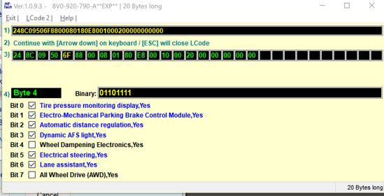

                    hmm... of course lots of possible causes for the car believing that it has "active TPMS". Assuming that Stage 1 installer hasn't activated the specific "active TPMS" module in the CAN Gateway installation list - the other setting you might want to check is Byte 4, Bit 0 on the hex17 module - which should be set for indirect TPMS - see below
                    Don
                      That's exactly what happened. Now piecing my way through trying to enable passive TPMS again.

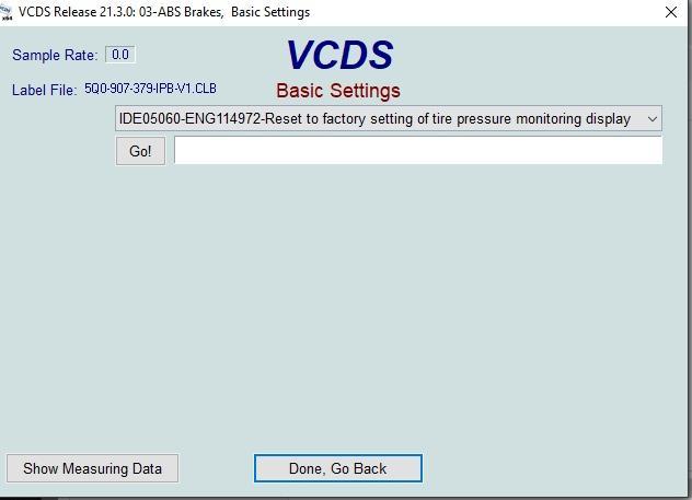

                            To close the loop, I fixed this using this function
                            For reference
                            Module 03 ABS
                            16 Security access
                            Code 20103
                            04 basic settings
                            IDE050060-ENG114972-Reset to factory setting of tire pressure monitoring display
                            Error gone. Works perfectly.
