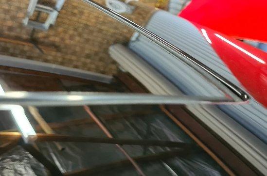

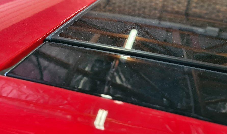

        Not sure if it's hard to tell but it dips down at the front and obviously is a bit higher at the back

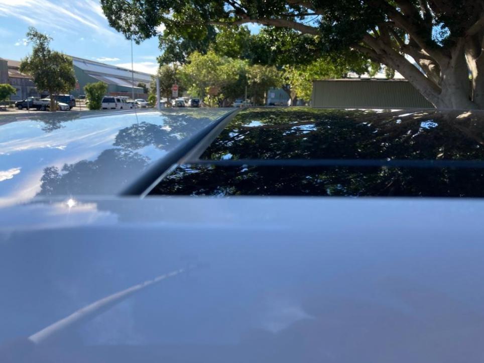

          Here is mine. Yours does look like its not aligned correctly at the front. You can fix it yourself easily if you have some basic tools, otherwise get the VW dealer to do it for you. I cant remember if they use Torx head screws or normal screws on the adjustment tabs, ill try to remember to have a look after work.

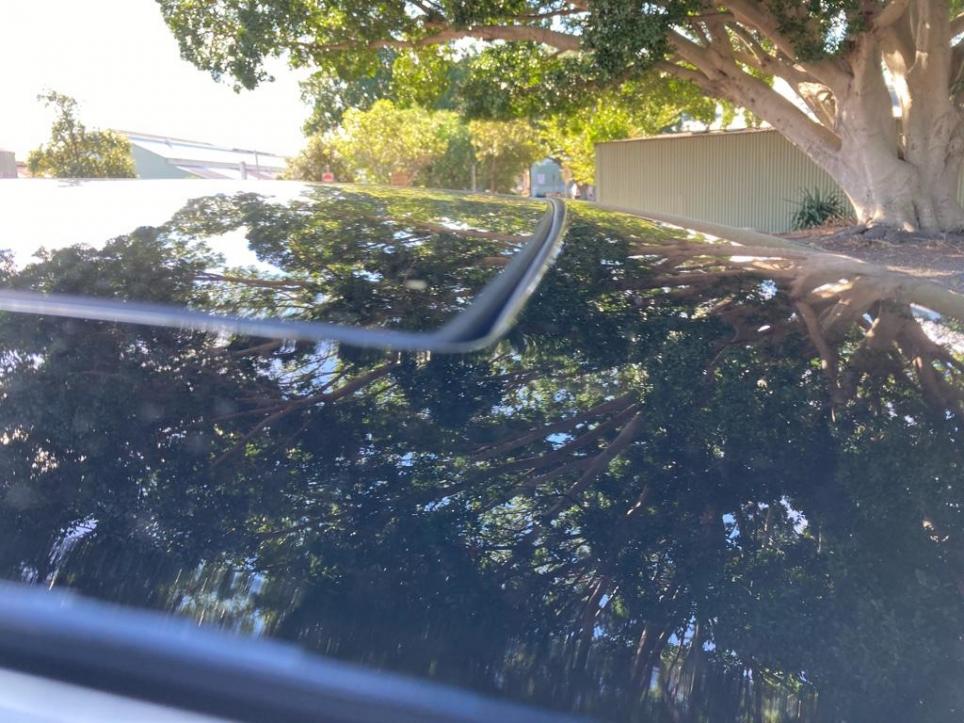

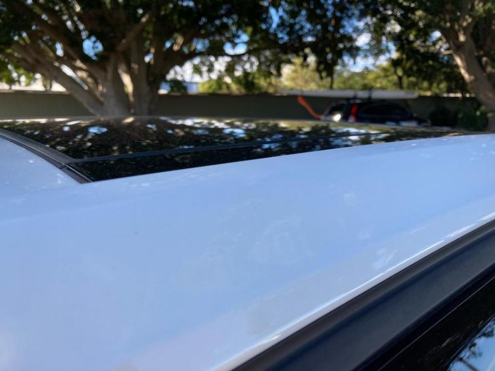

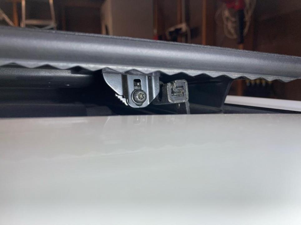

              It should be flat when closed and inline with your roofline as best as possible.

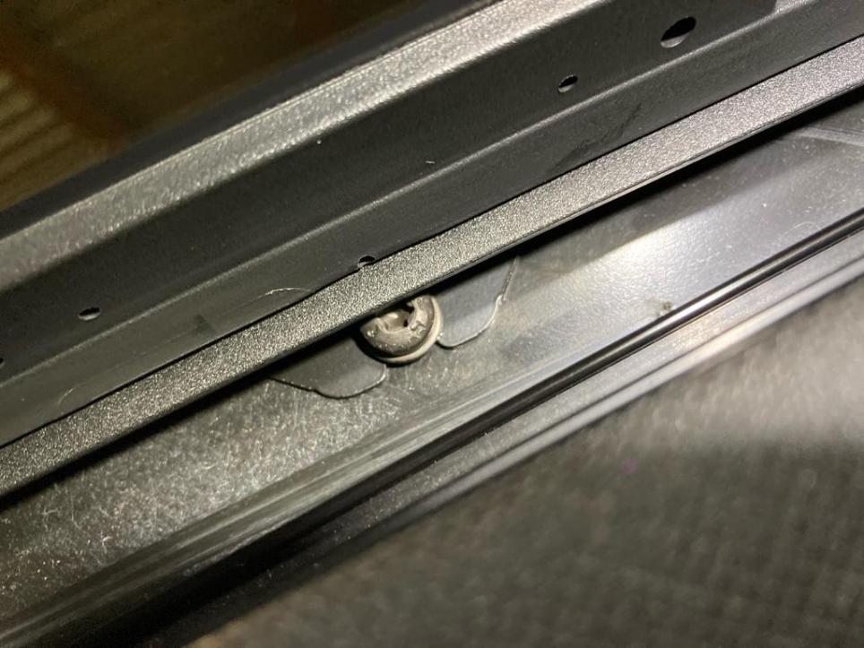

              The front adjustment tabs are accessible from inside the car. They are on either side of the sunroof towards the front.
              With the rear ones, tilt the sunroof up, then if you stand near the back of the car and look at the sunroof, you will see the screws on either side of the sunroof which are exposed once you tilt the sunroof up. If you loosen the screws, you can then adjust the sunroof (perhaps 1cm in total, up/down) to get it sitting flush with the roof.
              I will try and get some pics for you.
                Front
                Rear
                  Thanks, no idea why they left it uneven.
