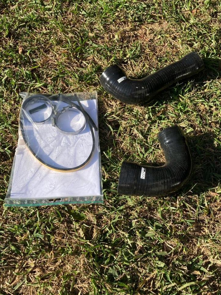

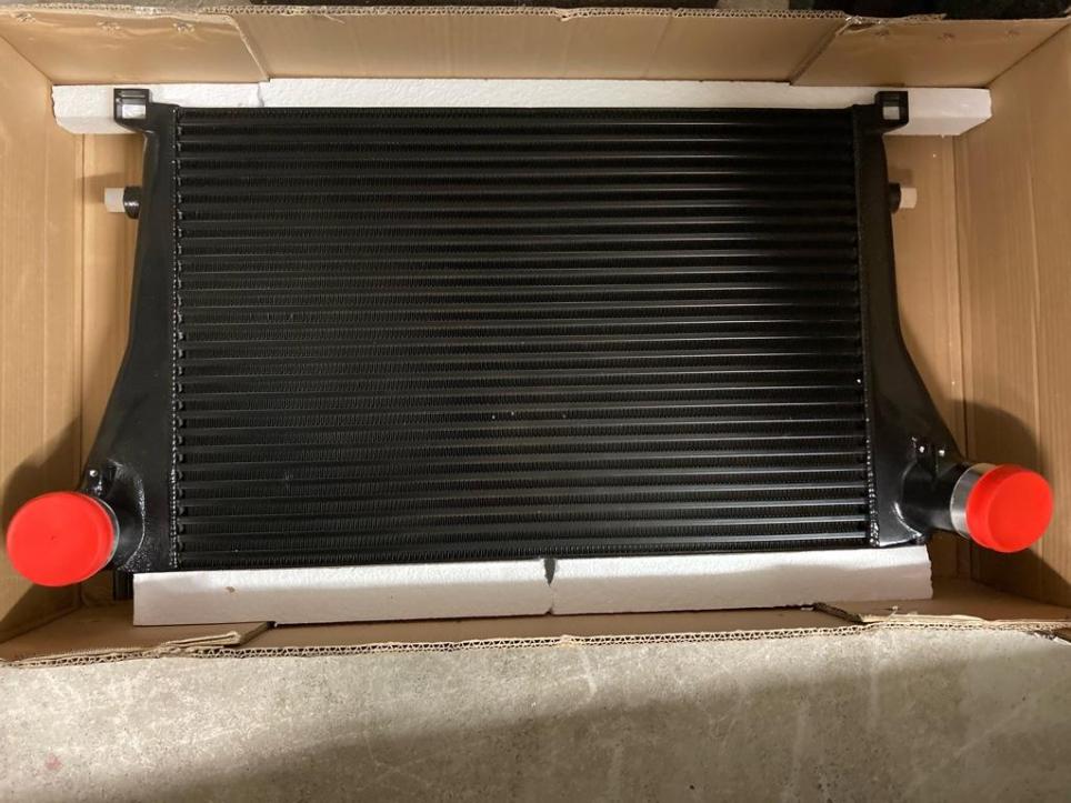

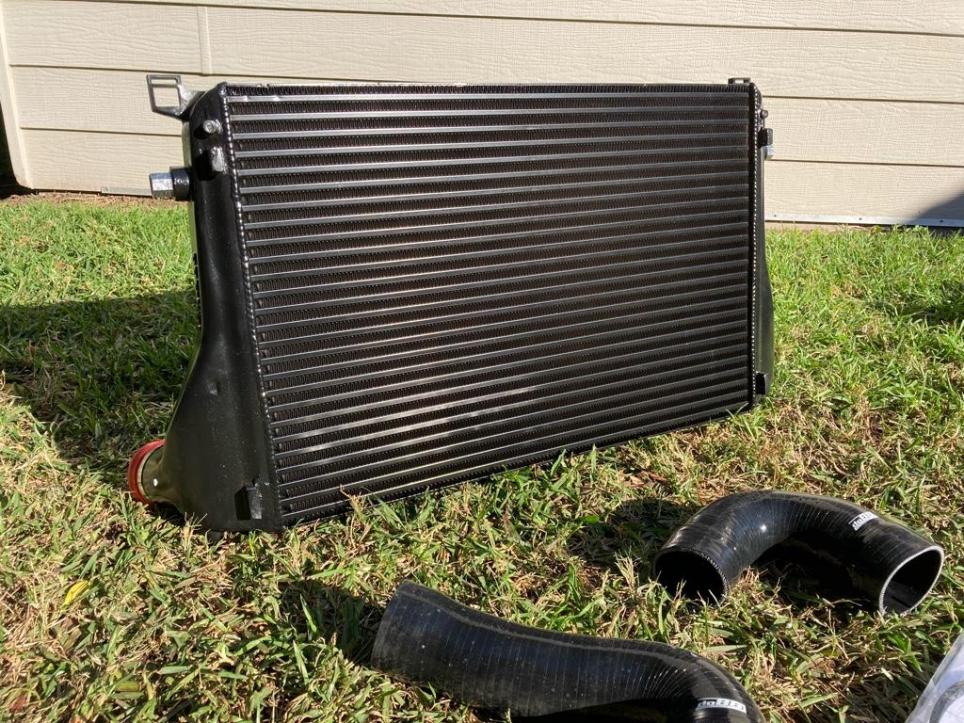

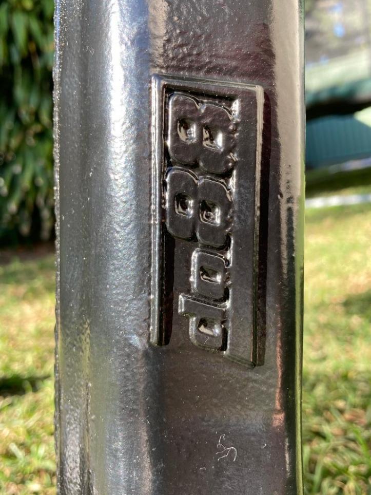

              Intercooler arrived and first impressions are good - it looks very nicely made.
              It was well packaged and arrived undamaged which is always a good thing. I would not recommend UPS for a courier, their tracking was hopeless at best and then once it arrived in Australia they hand it over to Startrack to deliver. Startrack use a different tracking number which was also useless and I am not a fan of Startrack from my previous experiences. So if anyone else buys directly from do88 in Sweden, pay a little more for the far better and quicker DHL shipping.

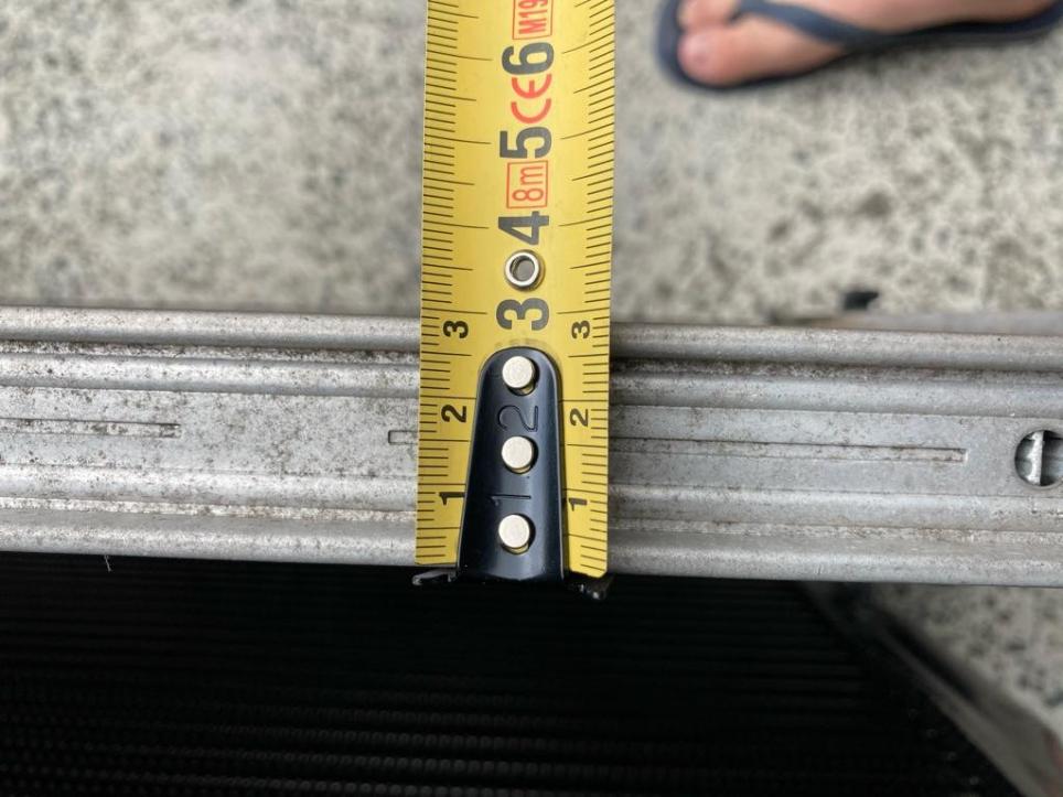

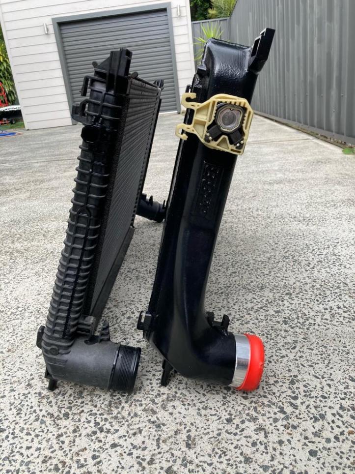

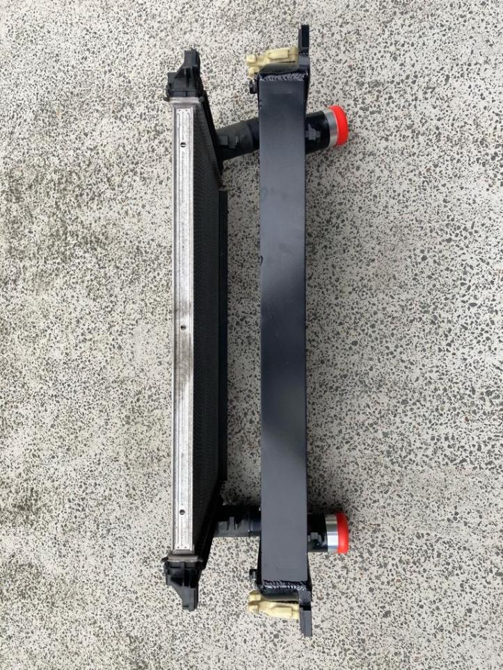

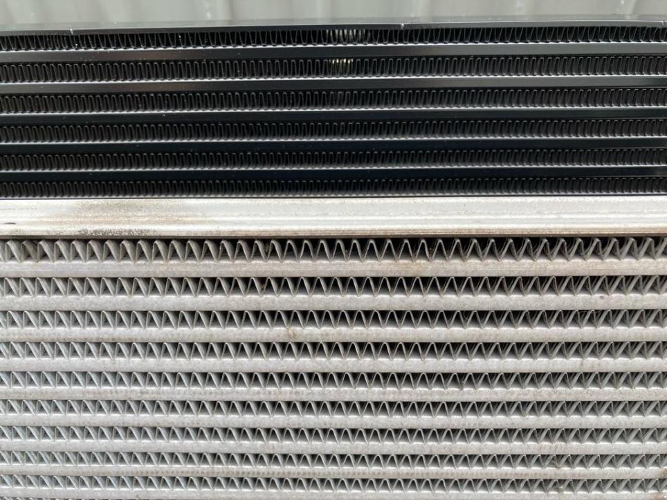

                  The original GTI intercooler is a very basic unit, obviously made to a very low cost and leaves a lot of room for improvement. You could easily upgrade to an intercooler thats 1/2 the size but with a better quality core, and have a better performing intercooler.

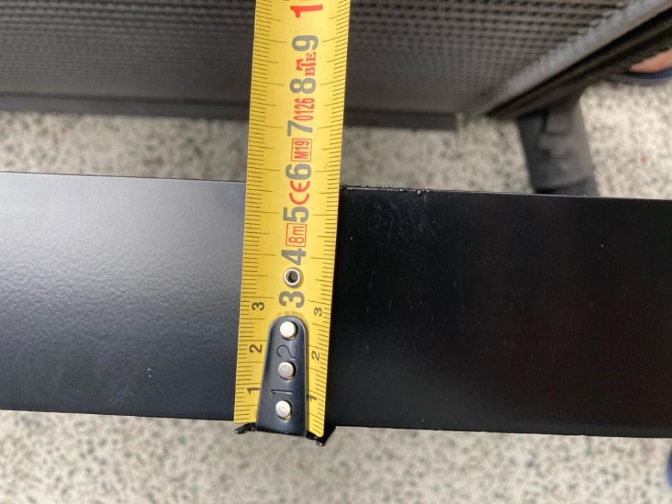

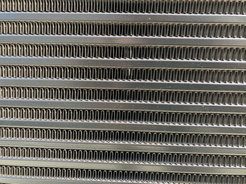

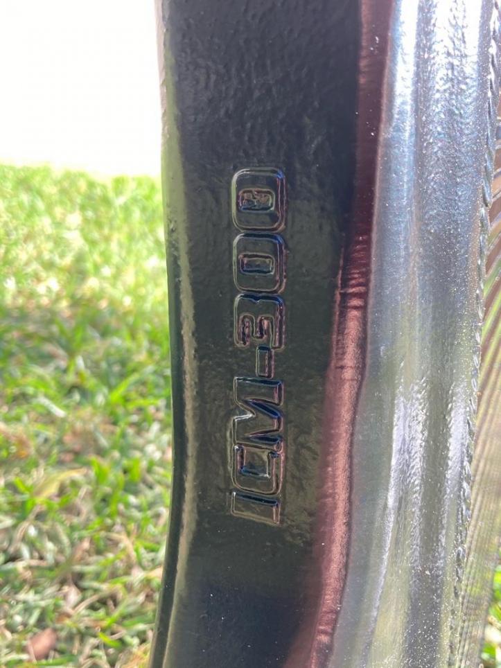

                  The new do88 intercooler is a considerable upgrade in both core quality, thickness of the core (from 30mm to about 58mm) and more durable larger capacity cast end tanks.

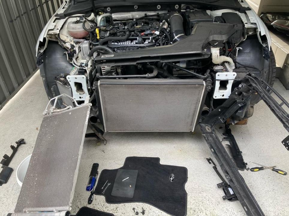

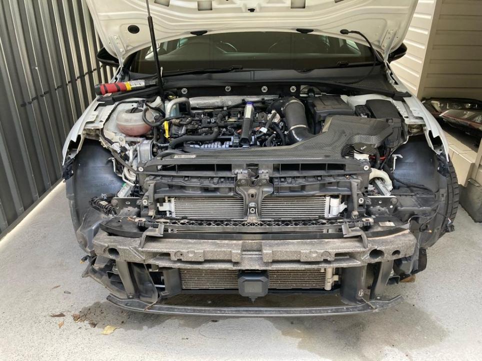

                  Time to rip the whole front of the car off. Thankfully my trusty battery powered ratchet wrench made the job of removing a million Torx bolts faster:

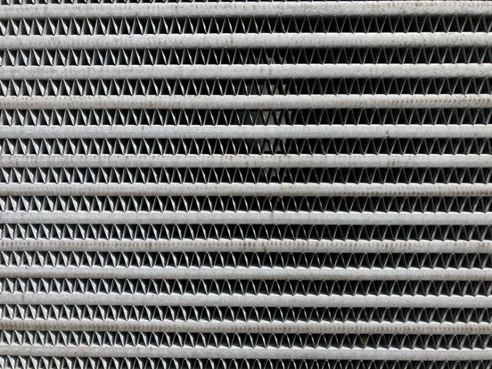

                  Standard VW intercooler core:

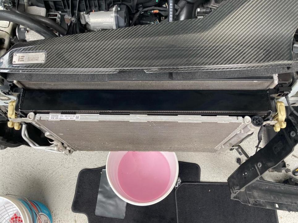

                  do88 intercooler core:
                  Core comparison:
                  Putting it all back together:
