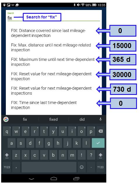

                And here is a screen-shot of the same channels from a mk7 using OBD11:
                Don

                        Again, there ain't nothing special about the arrangement that you describe; it certainly doesn't need a dealer visit (ODIS).
                        Think about how to use Time since last time-dependent inspection channel. If you want the service date to happen annually on a future date which happens in X days in the future, you simply need to do the following simple calculation
                        365 - X = Y
                        Then enter Y into the Time since last time-dependent inspection channel. So what will happen is that the counter in this channel will increase daily for X days until it reaches 365. This will initiate the service over-due warning!
                        This date will be the anniversary of every future service date accordingly:
                        1. If you service the vehicle on this date, reset the channel value to zero.
                        2. If you delay the service date in the future and if you want exactly the same service date - simply make the same calculation as above.
                        The dealer doesn't have any other way of doing this!
