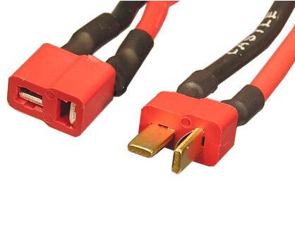

                      COuld you upload a photo I am intrigued by these gold connectors that can be left attached to the car.

                          ^^^^hmm...... OK - ain't nothing particularly special about the connectors -they are widely available and I've been using them for many years now on all sorts of battery applications both in cars, on radio controlled devices and anywhere where VD (volt drop - not the disease) and potentially high electrical current draw might be a concern. And of course, the connectors are corrosion resistant - so especially suitable for charger extension looms where the car owner doesn't want to have to lift the bonnet to make the charger connection.
                          As I said, lots of variants available on the net, but I'm tending towards Dean plugs of late (sometimes called "Tee - plugs") - Google the term!!
