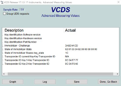

      notaGolfR:Hi and let me first apologize for going "techno" on you in my reply!
      Do you happen to own a diagnostic cable, or do you know someone close who has one? If so, then perhaps the screens below can be useful:
      The procedure to check the health of the key goes like this:
      • have the suspect key inside the car and turn-on the ignition
      • fire-up VCDS software and navigate to Adv. Meas. Values Option on the hex17 module (Instruments)
      • Tick the entries in the screenshot - particularly:
        • Immobilizer Challenge
        • Transponder ID Key 1-Key Transponder ID
        • Transponder ID Key 2-Key Transponder ID
      If the key is operating correctly, the entry in "Immobilizer Challenge" will be the same as one of the "Transponder ID Key" entries (I've shown a not registered key in the picture above)
      Don
