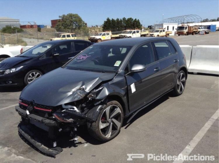

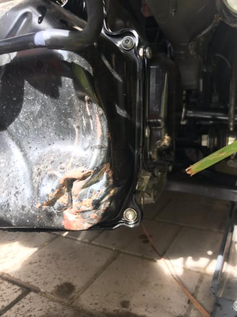

    I bought this beautiful Golf GTI MK 7.5 recently from the auction - repairable write off (600kms on the clock ), the front sustained damages to LHS front bumper , left hand side fender and a little bit of chassis damage where the fender bolts on and also gearbox ( metal covers & mechatronic unit ).
    After taking the metal cover off , I discovered that the mechatronic unit was broken in pieces , also note that the car is stuck in gear !

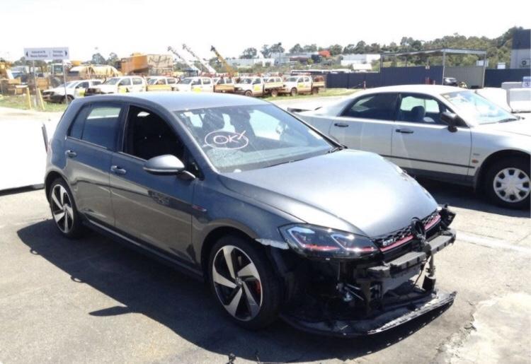

    Now i bought another GF GTI MK 7.5 stat write off from QLD 15,000kms on the clock (flood damage) for donor parts.
    Body is 100% but heaps off electrical warnings in the dash.
    Engine is 100% running & not affected and Gearbox warning comes on says faulty gearbox.
    But after pulling the electrical connector , there is no sign of water damage , no moisture in connector.

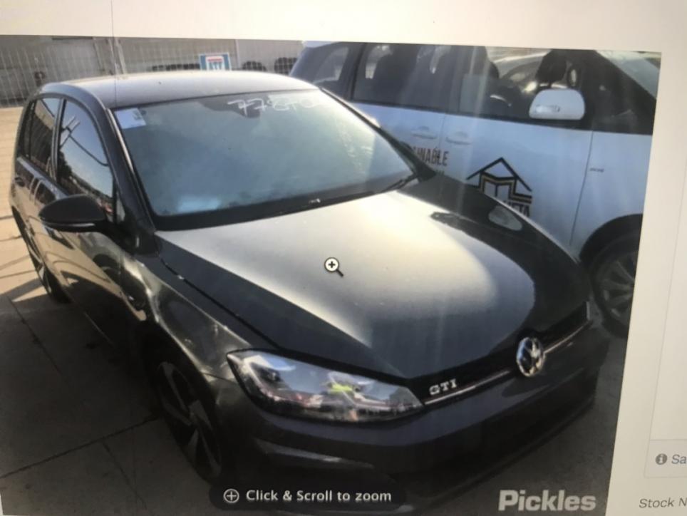

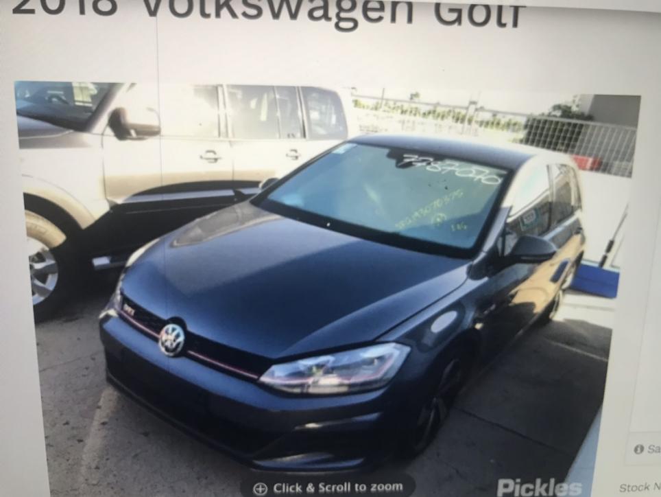

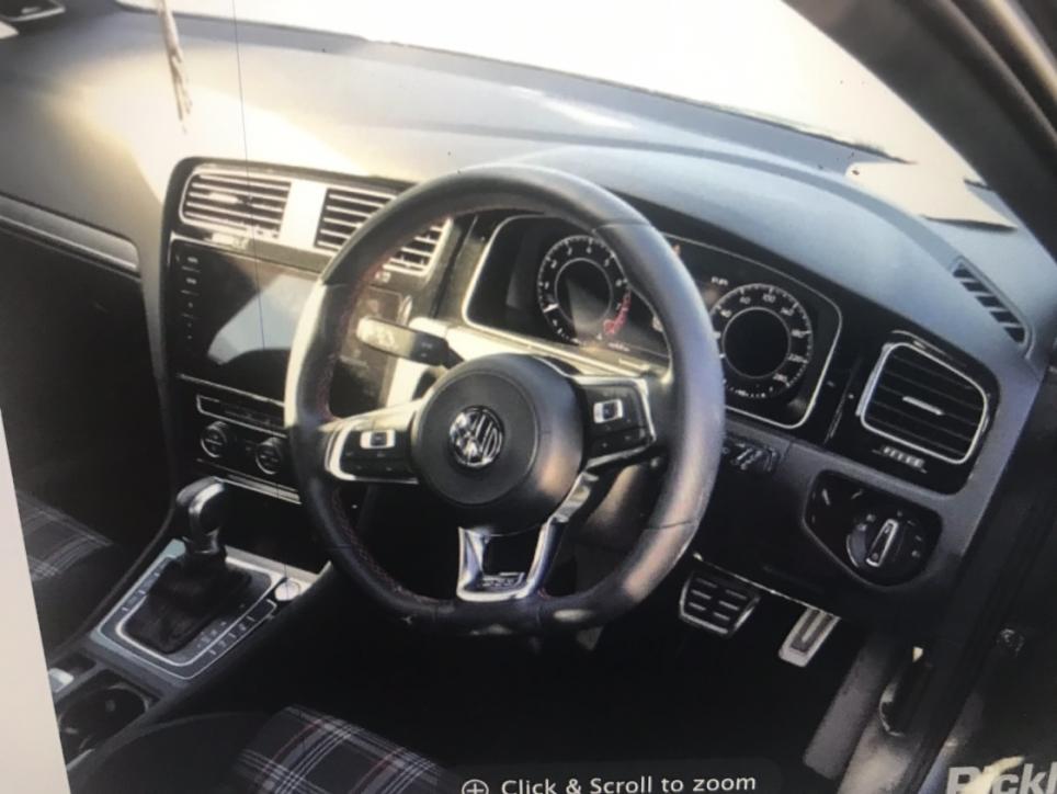

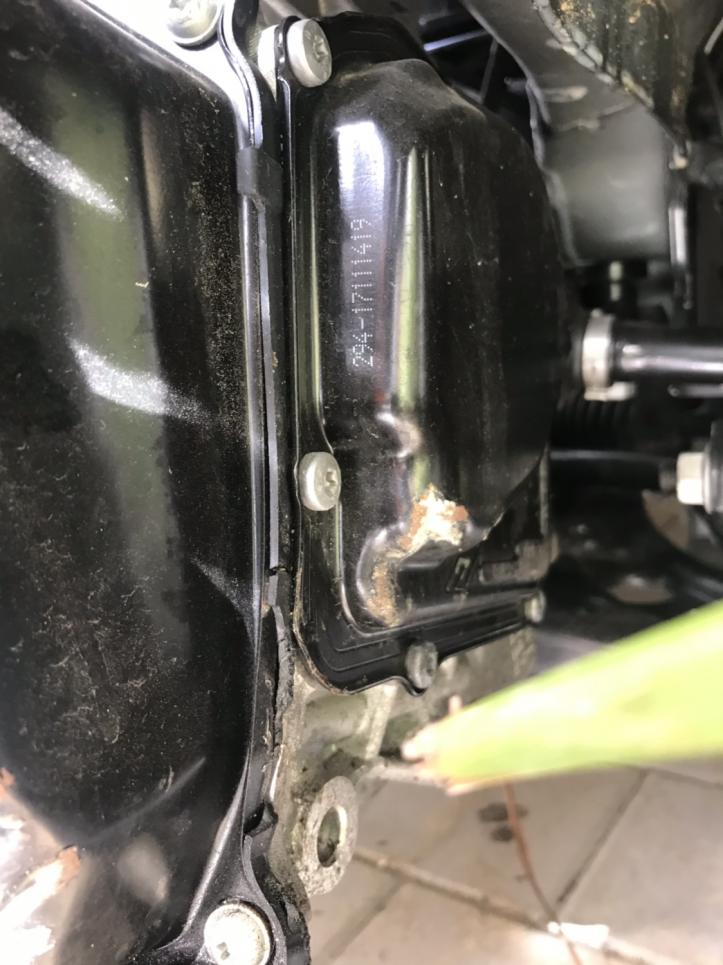

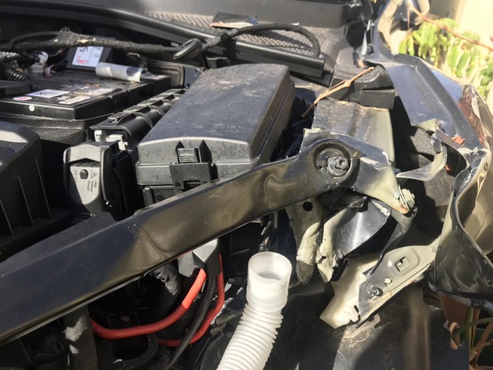

                      Few photos of the donor car :

                            If you have the time and space and both the cars there with you, I'd say try to use the donor's car's gearbox before looking elsewhere.
                            However, make sure they are the same .... 2018 GTIs (the donor) have a 7spd wet clutch gbox and older GTIs (not sure of the year model on your keeper) have a 6spd wet clutch gbox, so it may not be straight swap. If it is though, just go for it and if not, at least you would have learned something in the process.
                            Also invest in at least a VCDS cable (not the other cheaper junk) as that would be invaluable going forward, for scanning and coding.
