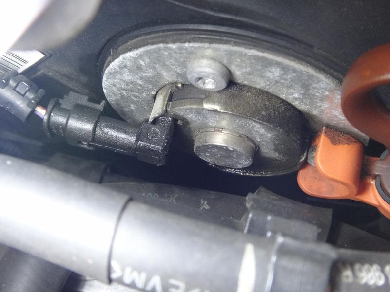

    FYI that is the cam adjuster magnet for the inlet cam.
    VW have released an updated part, and it is now made of black plastic - i updated the one on my car about 6 months ago. ECS Tuning sell the part and new electrical plug to suit.
    If yours is leaking oil then its likely that one of the 2x rubber o rings/seals have perished and is allowing oil to seep through.
    My original metal one was also allowing oil vapour to leak out, but the new updated unit has fixed that.
    Link to part on ECS Website

                        I had / have a leak from the same area - hopefully now fixed.

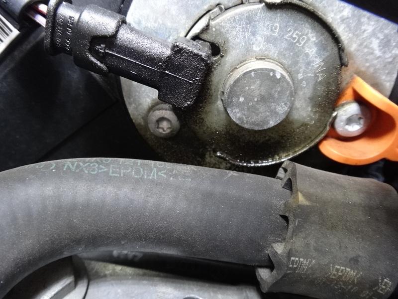

                        I pulled the magnet assembly yesterday and you can see that the o-ring has flattened. I assume it has been heat affected after 150,000km as there are no moving parts.
                        The original unit doesn't have the mounting plate fully welded to the magnet - there are several long gaps which allow the oil to leak through if the o-ring is weeping. While there is a revised unit that acts as a secondary gasket, I think you can fix the leak using the original silver unit (if it's working).
