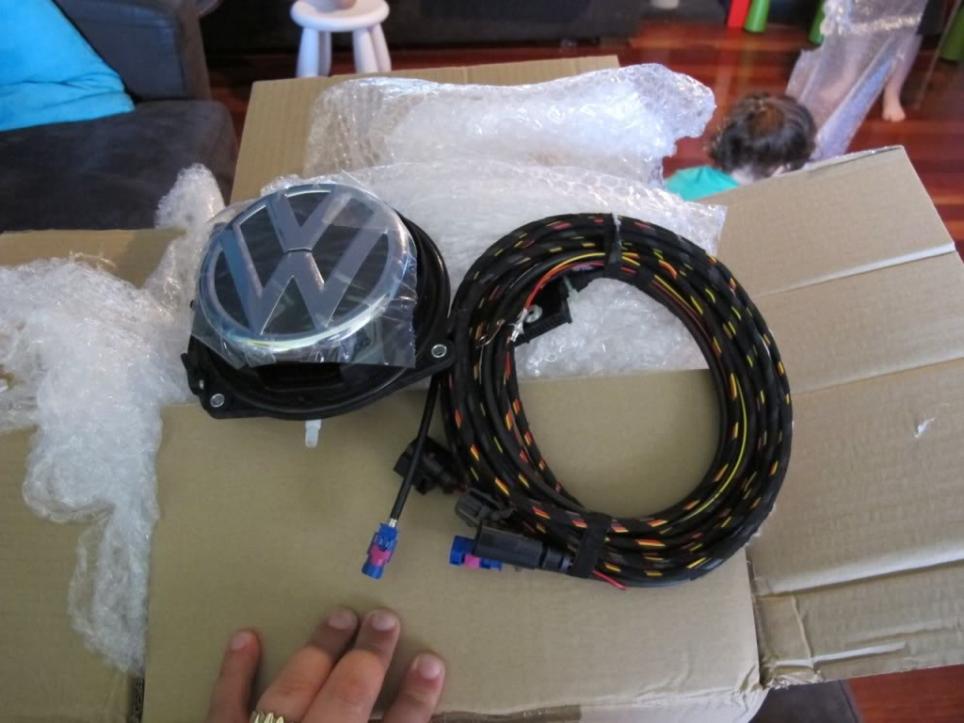

    After all my readings and ponderings I decided to take a bit of a leap of faith and see what was what in the world of RVC.
    I got bored of waiting for ECS so ordered this kit on Tuesday night from Poland for ~AU$460 delivered
    VW Rear Emblem Camera KIT - Retrofit - Golf 6
    And wow was it well packed and hot damn did it get delivered quickly! It turned up at lunchtime today so was ready and waiting for me when I got home from work.' I really can't recommend these people enough. It really is just a box of awesome!
    This kits comes with a full wiring loom and is almost plug and play. Compared to the ECS kit I was looking at before (and the instructions from the ECS website) the wiring seems to be a little different in that it doesn't come with a plug for the reverse light and it seems to have a ground not shown on the ECS diagram. In fact the power, earth and sense light are all bound together with the video line and come out at the front of the car... strange but there you go. Power I understand since it goes to the fuse box, ground… sure why not. But sense? I have to assume there is something you should be tapping it to behind the dash rather than the reverse light that all the other write ups I have read talk about. Sadly the kit didn't ship with instructions and I was too impatient to wait so gave it a bash anyway.

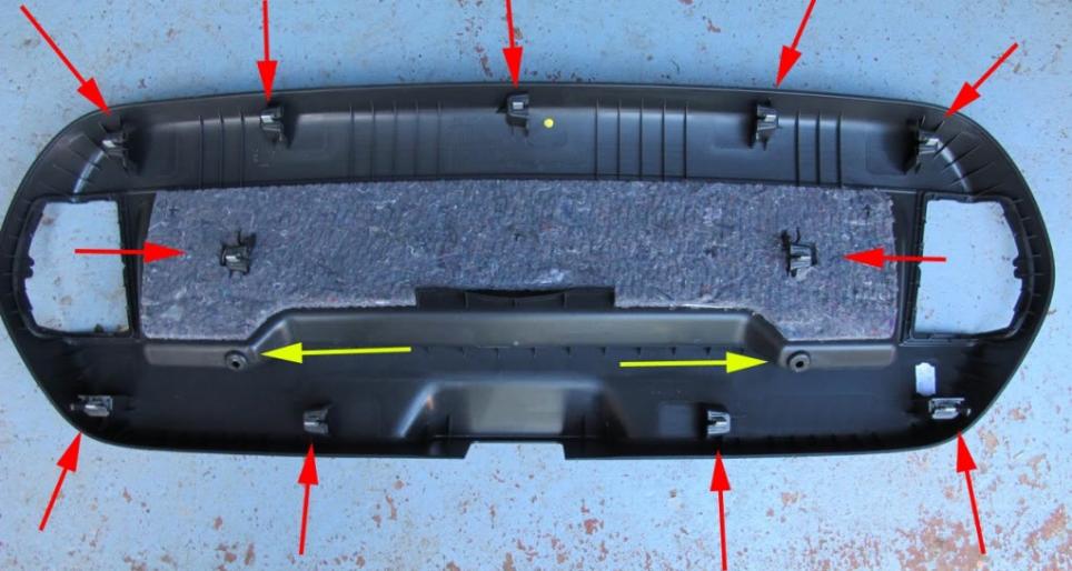

    To remove the boot trim there is two screws in the hand holds (marked in yellow) and a whole bunch of metal clips (marked in red). As with most trim pieces it's one of those things you just need to grab and pull. It's a bit scary if you have never done it before, but it does come off pretty easily.

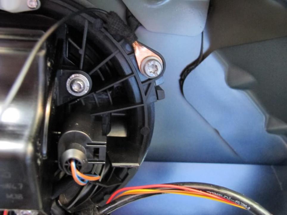

    In the boot I re-soldered and heat shrunk the power cable back in place and soldered in the O connector for the ground and used one of the mounting bolts for the camera as a ground point (which seems to work OK). I had a punch down splice connector so used that for the sense wire on the reserving light which only left the power cable to be connected at the front end.

    Earth Wire:

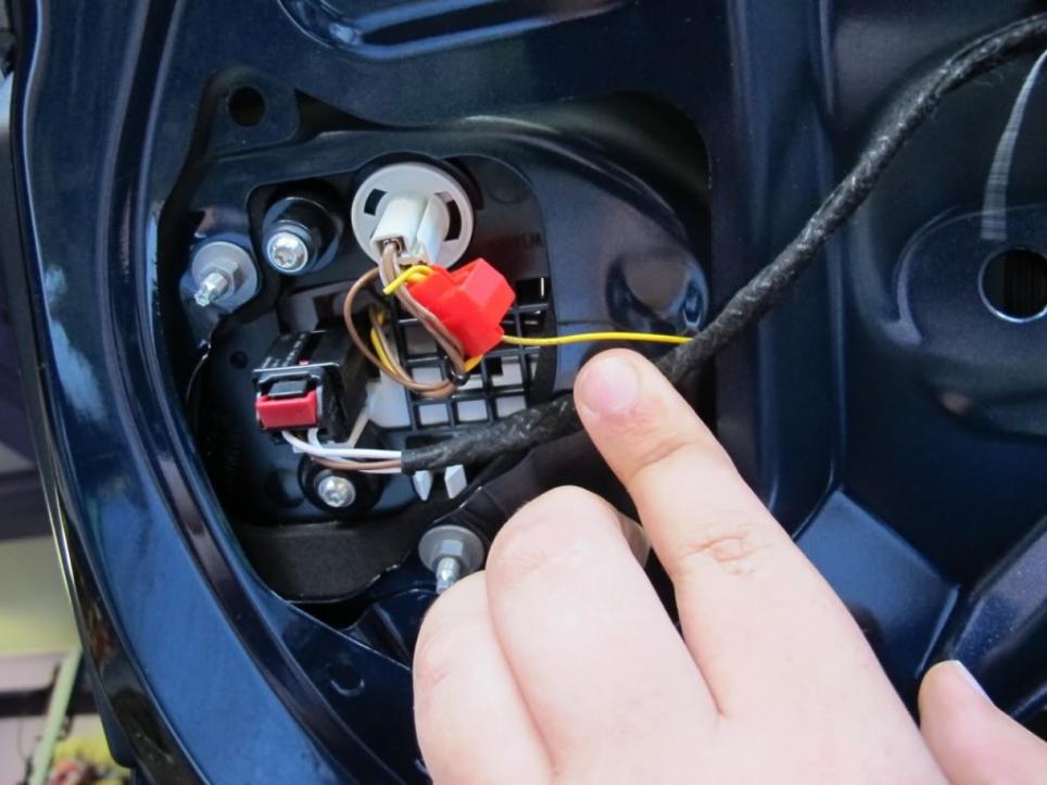

    Tap to the reverse light:
    NOTE: I wouldn't usually use this type of connector as they are prone to rattle loose over time, but it was late, dark and I couldn't work out how to disconnect that plug Something I might look at fixing later… but then probably not since it works.

    So bottom line, the unit seems genuine (it comes from around the corner from Wolfsburg ), it works and it's pretty damn cheap.

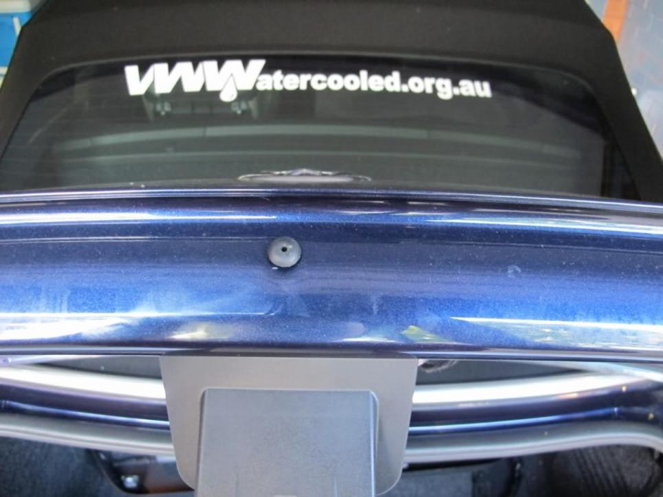

    * The drain pipe… seems the Cabriolet doesn't have one in stock form so I will have to look at getting one. On the assumption that it runs straight down to the little rubber grommet in my boot lid it shouldn't be a big job and one that other MK6'ers shouldn't have to worry about. But if you do:

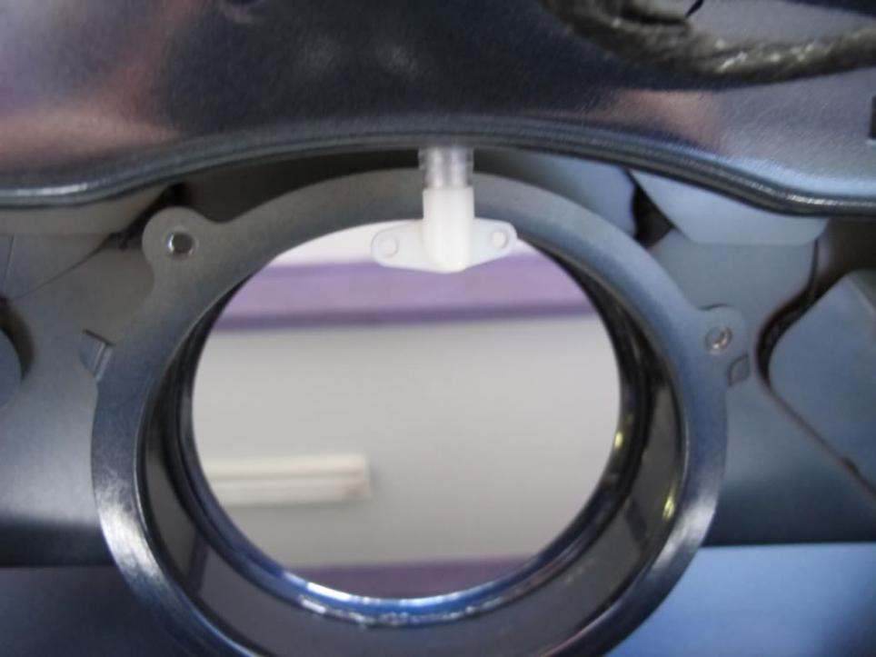

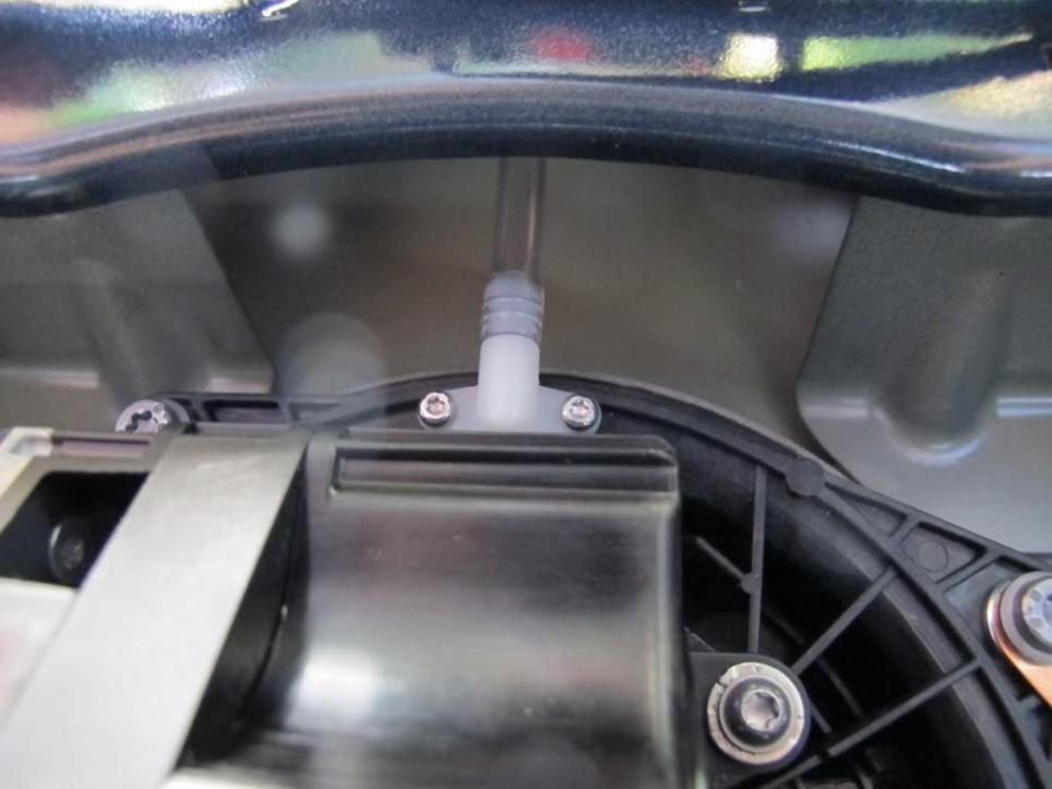

    EDIT: The drain pipe. I ordered one over the weekend and picked it up today for the grand sum of $14.65 Sure I could have probably made something up on the cheap… but really, it's under $15.

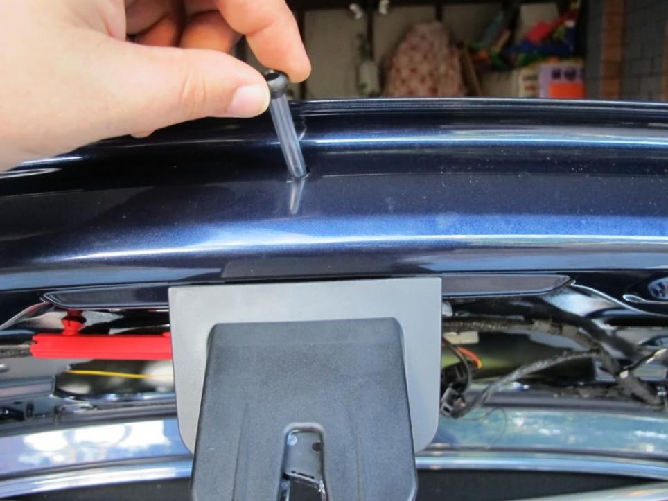

    It looks very easy to install, pull the bung:
    Stick the pipe into the hole:
    then simply connect it up…
    Then try removing the badge and trying with it all disconnected for a little extra slack…
    Then ask you wife to try since she has small hands…
    Then finally give up and do what I probably should have done in the first place. Unscrew the little white bit and put it onto the pipe, you will need a *tiny* torx bit (the T10 is too big). Luckily I have various bit sets and happened to have one small enough:
    And
    So now it's all back together and tested working. After a few trips out and about I'm very happy with it. The only thing I need to do is get something behind the car and reference just how close to things I can (or should) be reversing.

        Well done. I just got some old windscreen washer tubing that was from on older car which was a snug fit on the camera, and didn't require widening the exit hole.

            The long sense wire would be intended to connect to the reverse light circuit under the dash somewhere — you'd probably need the car's wiring diagram to find it (and most likely pull half the car apart...)
            Also, I think the instructions gave you a bum steer on the fuse requirement — if it's the genuine VW part a 5A fuse is specified (the actual drain is no more than 2A when the flap motor is running, the camera's requirement is insignificant (milliamps.))
            And yes, the drain goes to the hole filled by the rubber grommet — that's why it's there.
            Clark Rubber carry a very suitable plastic tube (you'll have to buy a metre, but it's only cents.) Do install it — you'll get water buildup inside the lid if you don't.

                  Yeah I figured 20A was a little overkill, but then the write up was talking about tapping into an existing fuse rather than adding your own. I do have some 10A fuses, so I might drop in the lower spec one and see how it goes.

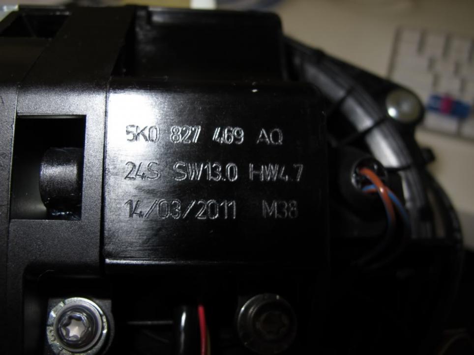

                  As for the drain pipe, it's ~$15 for the genuine part (5K6 827 861) from the local dealer. The part is ordered so can be dropped in on Monday.
                    I have updated the first post with some more pictures from the drain pipe install today
