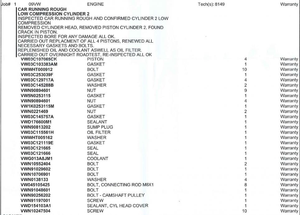

          • They only replace damaged parts so it depends on what was found at the point things were replaced. In my case it was only the pistons as I caught it very very early.
