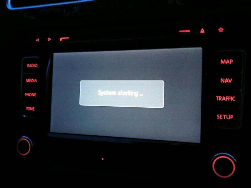

Hi Guys,
Not sure if this has been brought up before.. For about a month now, when I select Media (on RNS510) the screen freezes on the following prompt:
It happens intermittently.. Turning the unit off then on again doesn't fix it.. Disconnecting then reconnecting the iPod doesn't fix it.. I can still switch to the radio and view maps.. Pretty much every other screen other than the MDI is OK..
The only remedy is turning the car off then on again..
Anyone else experienced this??captain courteous enjoys vag
Are you switching to MDI shortly after the car/radio has started? Does it happen even if the radio has been on for more than say 2 minutes?
I seldom listen to the radio so yes the MDI is almost always the first thing to load automatically on startup after the 'Welcome to VW' screen appears. Normal operation it takes ~5 seconds for the music (ie the last track I was listening to) to start playing.Originally posted by Ryan_R View PostAre you switching to MDI shortly after the car/radio has started?
It did happen again last night.. Oddly enough when I switched over to Maps, there were no maps there! Just a black screen with my directional avatar & the usual status bar on the bottom.. At first I thought there was no reception.. But upon checking the GPS status, I had 4/10 satellites active..
Anyways.. Switching the unit off then on again fixed the maps thing.. Not the MDI.. I'm going to VW soon for the 7500.. Might get them to check it out..captain courteous enjoys vag
While the music from the radio plays as soon as the unit turns on from a cold boot, the rest of the computer is still loading in the background. It may be 20 seconds or more before things like Maps, Navigation, or external media become available. This is pretty normal behaviour. Usually mine will say 'xxxx is starting up' instead of just showing a blank screen though (has happened to me once though, when I turned the unit off before driving into an underground carpark, then got confused when I started the return trip).
Perhaps copy your favourite songs to the HDD or use an SD card, since they're somewhat more reliable audio sources.
I have seen that loading screen that just wouldn't go away once and rebooted the thing and it hasn't happened again.
(I don't recall if it was before or after I upgraded the firmware).
Q: How do you reset the unit if it crashes or otherwise requires resetting?
A: Press these three buttons at the same time: “eject” + “<” + “>” and that should reboot the unit.
