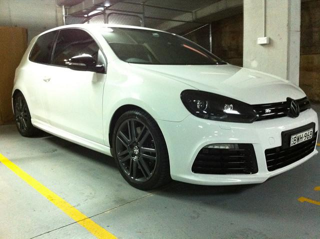

    Hi All.
    S3 wheels are fitted!
    Don't look anywhere as good as they did on the GTI... Offset is wrong, they look too far into the arches.
    I was previously correctly advised that I wouldn't have any issues with caliper clearance with these wheels. No issues there.
