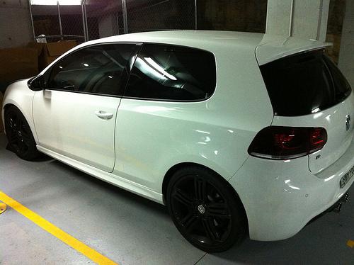

          Hi all,
          I've searched and there are plenty of threads on wheel offsets for different cars, but all specific to a particular wheel.
          Happy to have this thread as a general "Golf R - wheel fitment" thread.
          First up, I'm looking for some help.

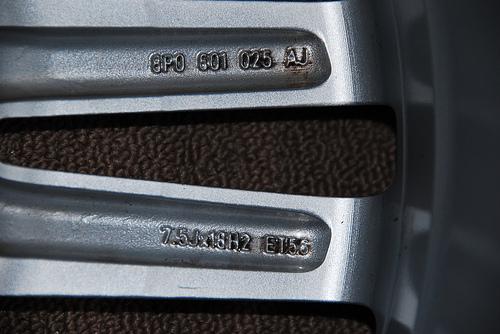

          I have some S3 wheels that I had on my old GTI.
          I want to fit them to my R. I have a CW 3 door R with black 19" Talladegas.
          GTI was on HPA SHS. Love how low it was (for looks, not the ride!)
          S3 specs are 7.5J x 18H2 ET56
          I have read that my 19" talla's are 8J x 19 ET50
          Can anyone suggest whether I'll have any issues running these wheels?
          Caliper rubbing?
          Any help would be appreciated!
          • Golf R runs same brake setup as S3,so should be no problem with fitment.
            I'm running 18 x 8 rims with 45 offset on my S3.
            • Originally posted by MACCAA View Post
              Thanks mate. Sounds good.
              Thanks for moving my post to this thread also!
