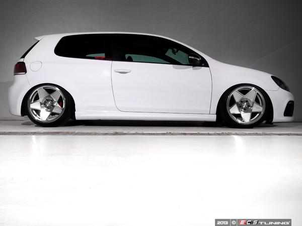

              • 18" Style 0.05 Polished Wheels - Staggered
                18x8.5 et42 / 18x9.5 et40, 5x112 73.1 CB

                  Wouldn't the rears scrape like a mofo?

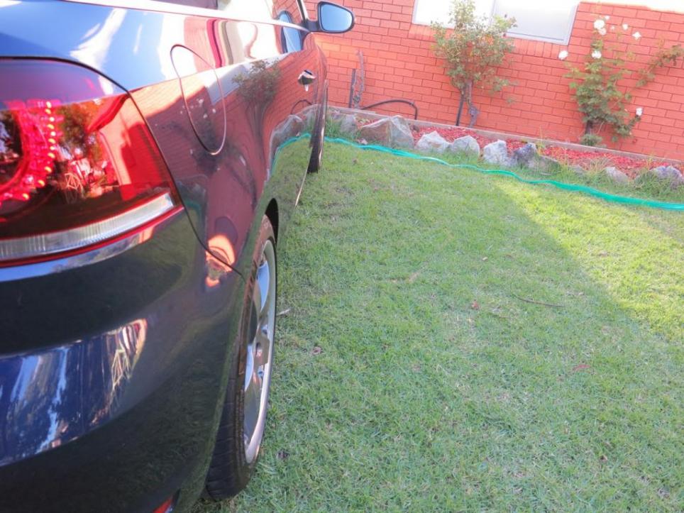

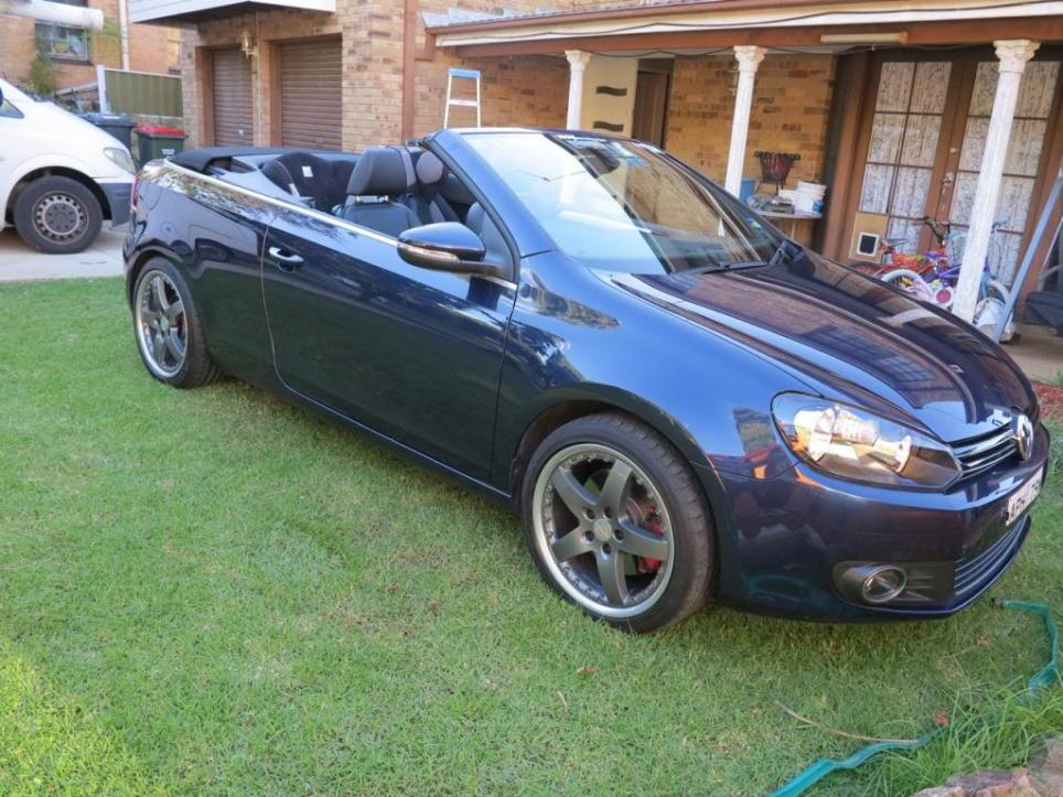

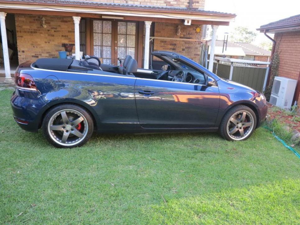

                    • Finally got some new shots of my Oettinger RZ wheels on after a tub:
                      18"x8"
                      PCD 5x112
                      ET45 (approx)

                          • Originally posted by The_Hawk View Post
                            These are sweet.. the charcoal/graphite suits the blue. Wish VW expanded their GTI color pallet here..
                            • MK6 Wheel / Rim / Tyre Thread
                              Thanks, you and me both on the colour choices. I'm a little sick of black, white and a few different shades of grey.
