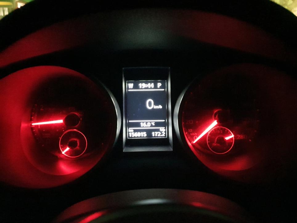

    I have a 2010 Golf Gti MKVI and my backlight on my instrument cluster has been dead for over a year now. I've asked a mechanic and they said I'll need to replace the pcb which can cost up to $800.
    Has anyone had this issue and know what options I might have in getting this fixed.
    Thank you.
