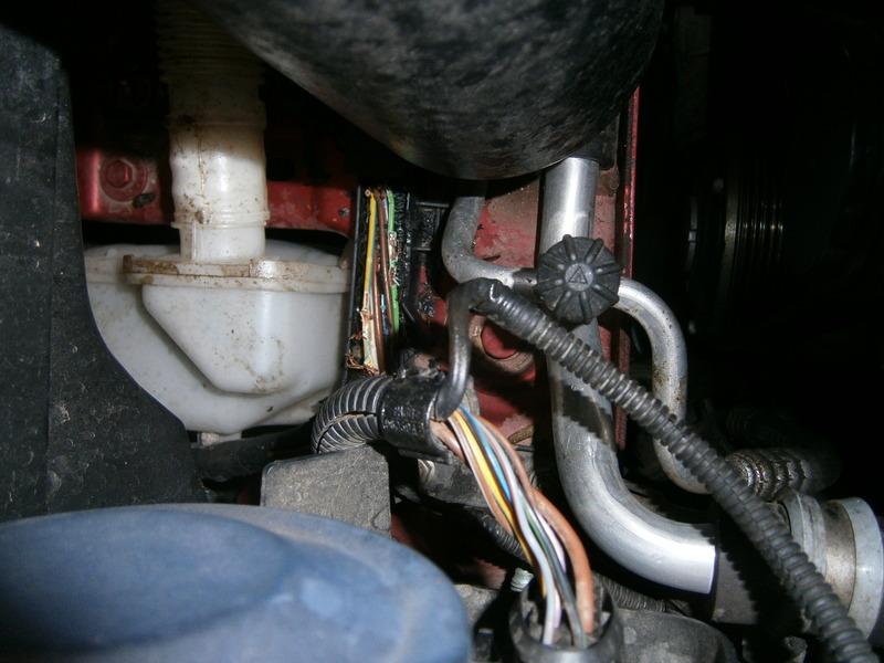

    Anyone else had this problem? Started car one night while out & noticed some of the dash warning lights didn't come on.
    Made it home OK but lifted bonnet in my garage & shone a torch around & confronted with this.
    Next day I pulled the front of the car to pieces to extract the damaged loom.
    I priced a new loom but found it would be made by hand, take 6 weeks & cost $10,000.[not a typo]
    I couldn't find a join in the loom as it past into the back of the dash & down the back of the motor.

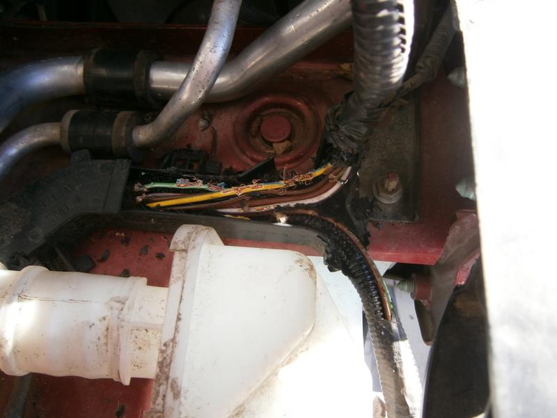

    The only solution for me was a repair in car.
    After tracing the colour coding on the wires I was reasonably confident of a good result.
    A friend soldered the wires together, slipped on heat shrink & wrapped with tape. Here's the result.
    Around next Easter I will be putting out mice & rat bait at the first sign of mice/rats. I am also leaving the bonnet open. The mice like a nice warm & dark place. My wife has also hung camphor blocks in each engine compartment. This year in SA we have had mice plagues & have had mice in 3 of our cars.
    My friend ,who soldered the wires together told me there is a class action in the States against Toyota who are using wires that have soy in the insulation that is proving very tasty for rodents.
    I have started the car & everything looks good. Now I just have to put it all back together again.
