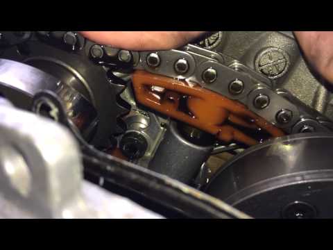

      Sounds like the cam chain tensioner. The camshaft is belt driven but the intake cam is driven via a chain on the exhaust camshaft.
      RE:
      Not a huge job but not a one hour job also. Is the noise more so from the rear of the engine/high pressure pump area? And would you describe the sound as "diesely"? If yes to those, then most likely it's the cam chain.

        Thanks for the replies, guys.
        Yes, it certainly sounds diesely. The noise seems to be coming from the back of the engine (if you're standing and facing the car while the bonnet is open) and more towards the left. So, I guess where the chain is.
