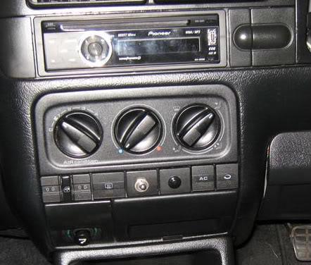

              You wouldn't have happened to find one of these for a MK4 Bora/Golf?
              To anyone that jumped in the car it would look stock, until you actually read them. I think its great! Thanks for posting

                  That looks like an awesome little mod, makes my buttons and switches look a little crude in comparisson... but they work:
