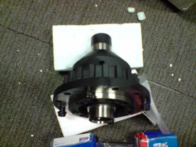

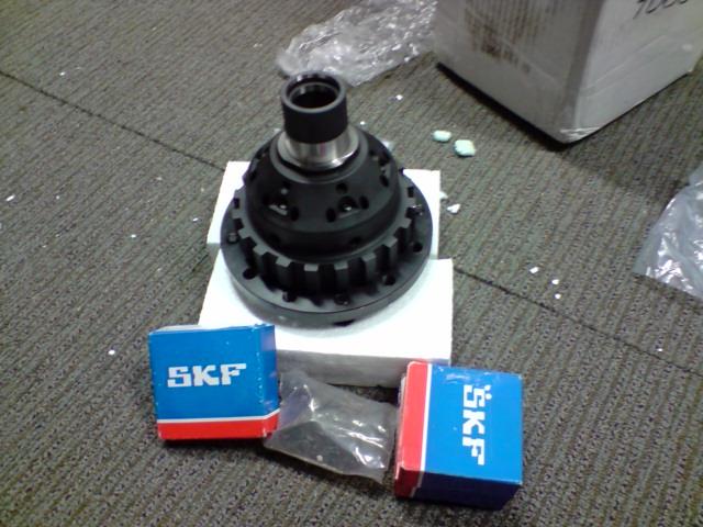

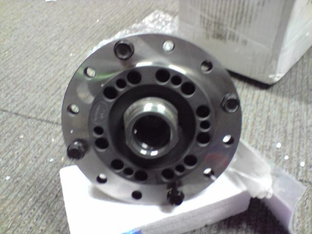

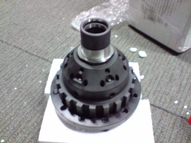

              Caught up with the boy tonight, Tony and Hong from golfmkv whilst getting a custom tune flashed from GIAC by Eurospeed.
              Saw Hong's new toy, a Peloquin DSG LSD. His also ordered the VF RSS kit. And because of that I've decided to get the RSR kit with new internals . I believe his will be the first to put a LSD on a DSG gearbox in Aus.
              Here's some photos he took.
              It weights about 20 kgs, but the stock diff in the dsg probably weighs the same too.

              • #22
                Sorry Andy,
                There are at least 3 GTi's with the LSD on DSG in QLD alone! - (since August)
                Saying that he will love the difference it makes!
                • #23
                  How hard was the install and how long did it take. I know there is so machining required.
                  I'm interested in how the DSG LSD is done, do you have any images of the installs?? Like to see the internals.
                  How much did you charge for fitting?
                  I don't think you will really feel the difference of the LSD on the road. Mostly the benefits will be felt on the track or drags. Hence why I'm planning on getting the most power out and see what the DSG can handle in terms of power before messing with it.
                  Are those guys with the install on the forum, would like to get some direct feedback off them

                  • #24
                    Originally posted by Guy_H View Post
                    Sorry Andy,
                    Very nice.
                    roughly how long did it take to install?
                    did the engine need to come out?
                    Is it a clutch pack type 1.5way LSD or is a viscous type LSD?
                    do you have these members contacts so i can gather more information off them?
                    Cheers
                    • #25
                      All the diffs were installed by VW dealers - only machining is the rivets which hold the main gear on the diff centre. ~ 10 hours to install dealer time, so not too bad.
                      Big difference - one of the cars has the APR 240kw K04 kit on it & the customer raves about the difference and the ability to put the power down.
                      TRGTI, they are a torque biasing differential, I have the phone number of one customer who gives his a hard time. One of the others was done for a dealer who is using it for track training / tarmac rally type stuff. Send me an email & I'll put you in touch with an owner.
                      A full clutch type (as far as I know for manual gearbox only) when I priced one in June were $7500 USD + Shipping - for a full race car this is the way to go, but too expensive for me & our track times in our 400hp GTI are pretty good
                      If you talk to Dean at Volkspower, he has a TBD installed in his GTI (APR 240kw) - he has just run it at Phillip Island & Sandown, so he can give your the rundown on how it works & what its like on the street as well.
                      P.S engine stays in the car
