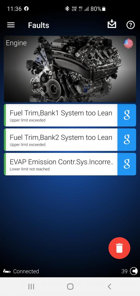

    My Mk5 R32 has started throwing the above error codes and yesterday illuminated the check engine light. Anybody had experience with these codes or know common things I should be checking? The car still drives fine but does seem to stumble a bit on startups so it doesn't seem too serious.

      I got the P0441 code sorted, turned out to be a bad hose on the charcoal canister. Replaced that and that code hasn't come back, neither has the check engine light so it seems like that's what was triggering it. The other 2 are still occuring, if I clear them they're back within a few hours. It does have a stage 1 ECU remap on it but it's had it for a while. Will see what VW reckons when it goes in for a service in a few weeks.
