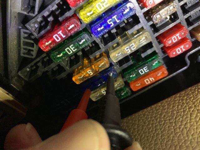

        Hi - I feel your pain, I need to do the same for my GTI.
        I’m starting with a voltage drop test on each fuse to isolate which circuit is causing the issue.
        (I too have an aftermarket stereo but I’ve had the car w stereo for 5yrs and the drainage issue is new).
        There are tables around to identify a) which circuit is which and b) how much voltage drop on a fuse of x resistance = current draw.

                    I have this battery draining issue whereby if i left the car stationary for more than 3 days, the battery will be flat.
                    Not too bothered with it till i was sick recently and when i need to go out, the car is dead...
                    I have used the same method as well
                    Went to ERWIN to purchased the diagram so that i can know accurately which fuse is linked to which component (maybe the car manual have this info as well but just want to get other diagrams too)
                    I found that the fuse connected to CECM is draining quite heavily, around 0.9mV across 10A fuse which is a sympton that the canbus is still active when it suppose to go sleep?
